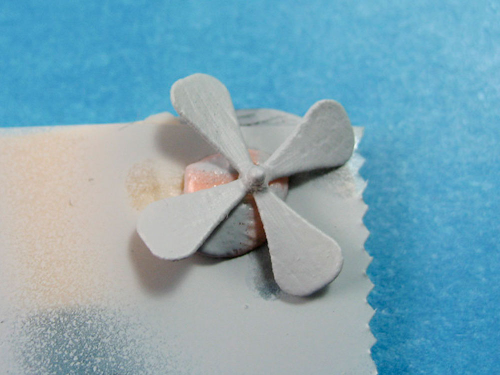

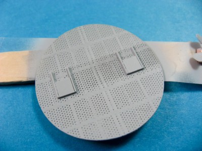

Okay, here's what we're working with. Initially I thought the printings to be flawless, but as they come in that translucent/clear medium that Dean showed with his test turret image, it's hard to see exactly what's going on until you get some primer on them.
File comment: The turret roofs are amazing. The tiny holes are all there and the Mr. Surfacer primer didn't clog them up! These are good to use as-is.

File comment: The props have just a little roughness to them, but a little sanding and they'll be good to go. Only showing one of the four here. I forgot to put an item for scale in the photo, but the props are 12mm in diamater.

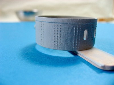

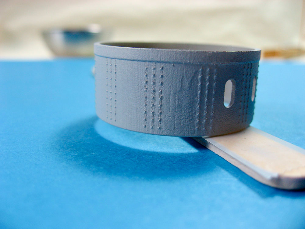

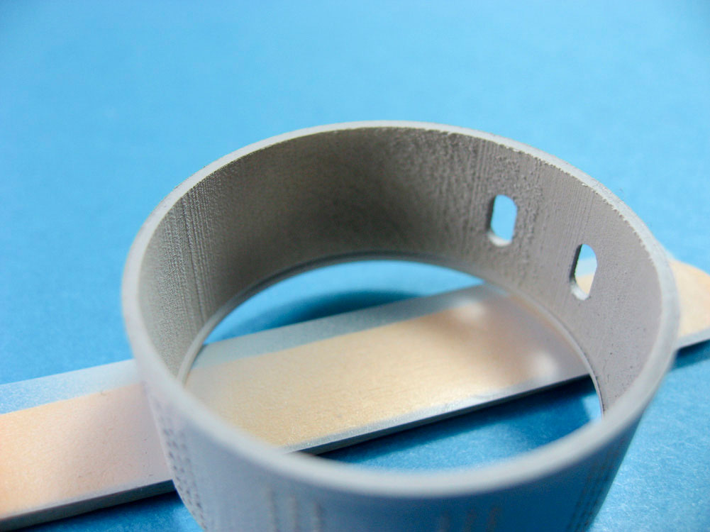

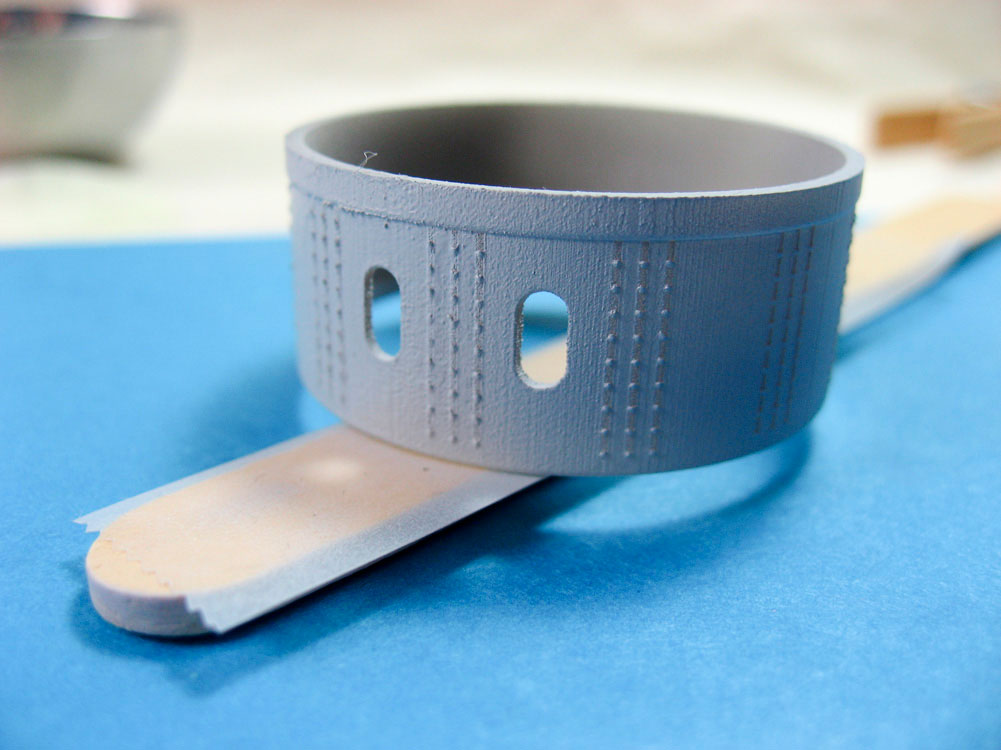

Now on to the turrets. They're a mixed bag. The limits of the printing process for smooth cylinders show here as they did on the Dahlgren. One note: when these parts arrived they had a slightly oily texture. I soaked everything in Simple Green for an hour, then tooth-brushed them and rinsed. Then most of the parts had a stickiness to them, kind of like uncured resin, or paint that hasn't fully dried. I brushed them down with lacquer thinner and they were then fine to prime.
File comment: The overall view from the front is really promising.

File comment: The interior is a little rough, but some sanding will knock that down in no time (and, honestly, how much will be visible inside a 1/200 scale turret?)

File comment: And here we see the problem. Roughness that wouldn't normally be a problem to knock down with a sanding stick, but now we're dealing with the bolt heads. This will be a tricky one to figure out. Maybe I can sand just this part and get close enough matches with some resin rivet decals. We'll see.

That turret does look rougher than the one I have. Is that material or primer between the rivets?
Because the one I have doesn't look like that, even the interior on mine looks smoother. I'm wondering if the simple green or lacquer thinner didn't soften or melt the plastic some, because it looks like some of the rivets were mushed too.
If you want, I can send you the turret I have, I'm not going to do anything with it anyway. You can use it to replace that one or as a spare.
With the cannon, except for the steps, the shape does look pretty good, it just sucks that it didn't come out smoother. It definitely shows the limits of printing small stuff.

I looked at the other turret I have, and wouldn't you know, that with a 50/50 shot, I picked the one with the problems. The other one looks really good. I'm sure it isn't primer, I use Mr. Surfacer and that stuff doesn't build up or flake like other stuff, plus if it had then the roof and props would have shown the same results.
