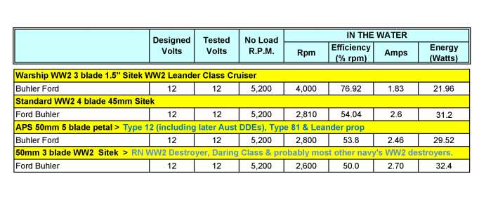

We use this guys Ford Buhlers in many of our club models. Just send him, Sebastien, a message and he'll get back to you. He is in Canada. Some tst resultsa to give you an idea of the performance attached.

I PMed him and he and no idea why you thought i should have contacted him. Do you have an email addy? Also I fond the below brushed DC motor that seems to be close to the one at the top of your chart. What are your thoughts on using 4 of these motors for my 84" CAG? Specs below:

Odd, he doesn't seem to be active now. We lat bought 12 months ago from him anf have been buying since 2008 from him.

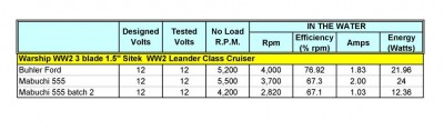

They should work, we did use some 555s but they ran hot and used more amps than the Buhlers. A 5 pole motor versus a 10 pole motor. The other problem we hit was when we bought a second batch and they gave completey different results to the first batch. :scratch:
