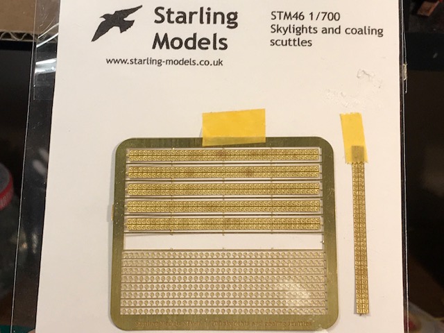

I build in 1/700, but skylights should be pretty straight forward in 350 as well. I’ll typically make them from styrene strips, making a peaked “tent” an inch or so long, adding a base when the tent is dry then cutting to length and then adding square or rectangular openings from styrene stock.
Generic covers may be available in 350. I have some in 700 from Starling Models which I like.
-- Scott
