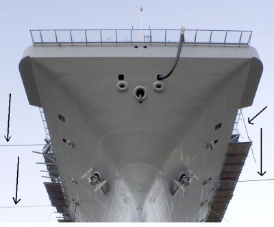

Thanks for the info; do you know if they are painted red below the black waterline?
Also and I know this may sound dumb to most of you guys but what are things that look like antenna's?

The items that your pointing out on the photo above are 35' whip antennas in their down position, these are hinged as to get out of the way of flight ops.
The carriers had a 7 to 8 foot black boot top and then red below that. another note of interet is that the boot top could be 7 feet high at the bow but only 3 feet at the stern, the top line of the boot top is parallel with the base line but the bottom of the boot top angles upward along the entire length of the hull.
Thanks for the info :thumbs_up_1:
I always wondered what the antennas were, or even if they were antennas at all. Thanks again. :woo_hoo:

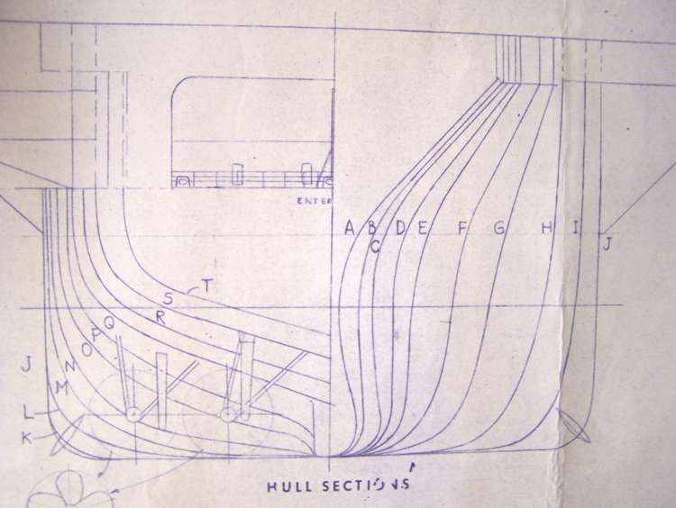

hi Admhawk could you post the pic of the left or right view of the hull section please?

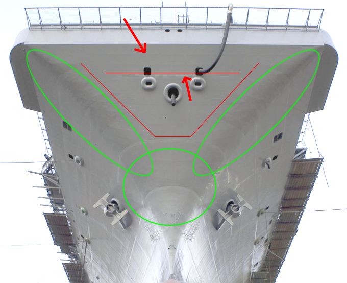

I wouldn't say that the model shown above is wrong. But I would say that the edges need to have more curve put into them.
I understand what you are saying, but I think it is matter of degree. Yes there are curves in the bow. But I don't see as much as you see. What I see is shown below.
In this pic of the Reagan, you can see a prominant weld line go across the front and some creasing from internal welding above it. To my eye, they go straight across for a large portion of the front. The red v outline is what I would call flat. The green circles are where I would use blocks/putty/sanding to make the sides curve into the front.

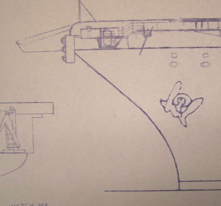

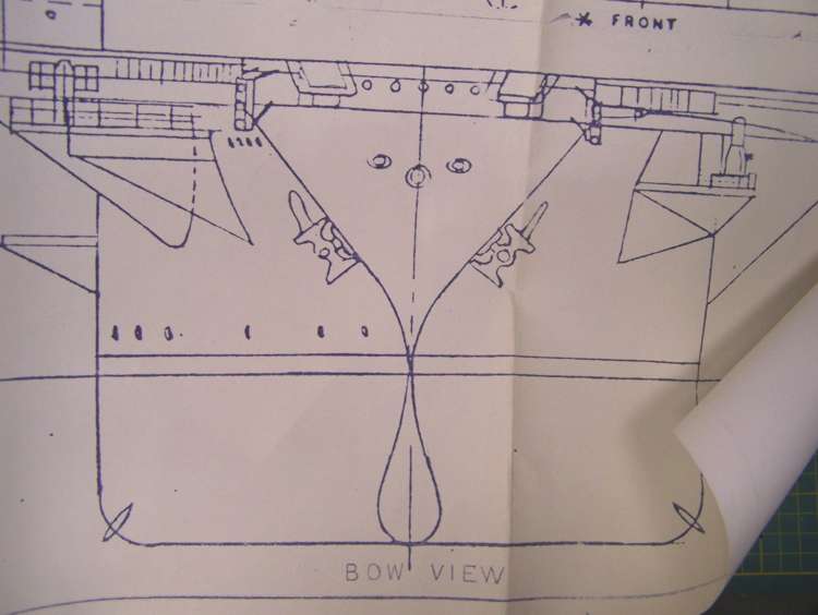

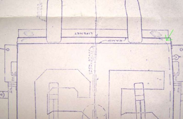

The following is a set of plans I got from Floating Drydock. They don't show the curves as much as I would like, but you can see that they are understated, rather than over stated.
