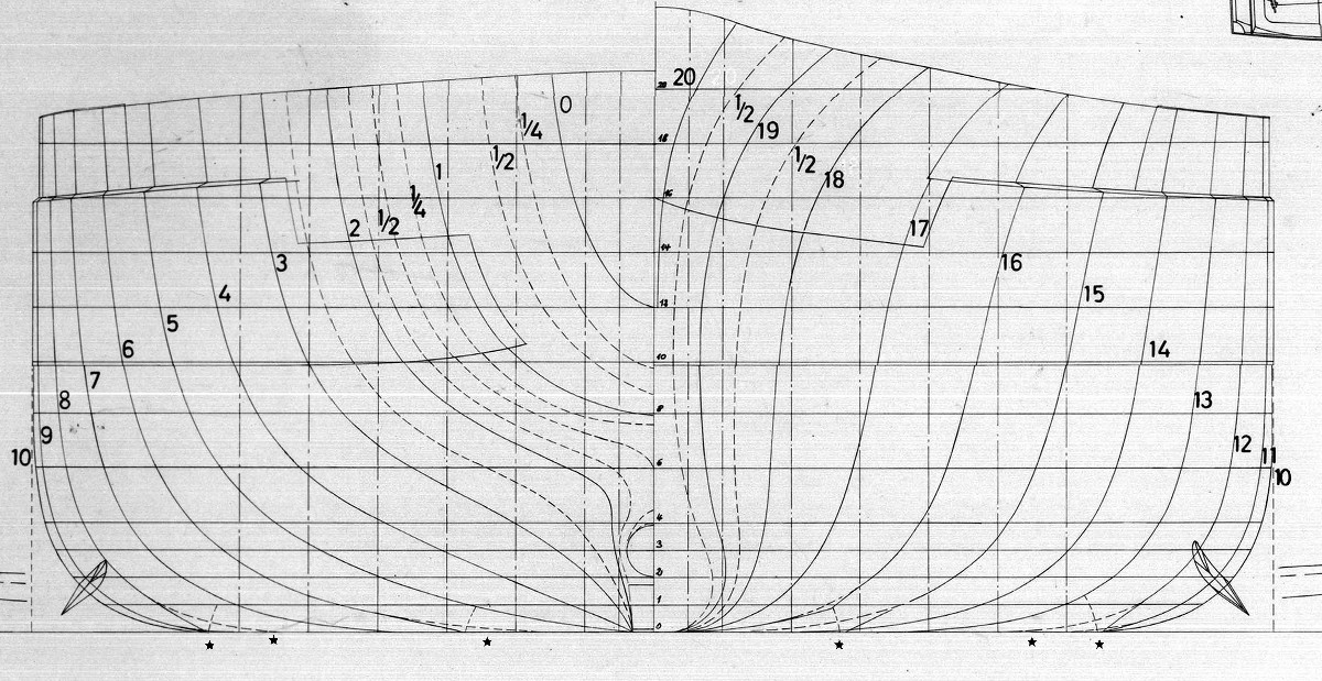

The next thing I am struggling with my line drawings show a camber which I assume is the camber of the deck for water run off, but I will be making my bulkheads like ribs and will be flat so that I can then put a deck on top of this which will deal with the camber but I am struggling to find how to adjust my Bulkheads Drawings so that I can have a flat area for putting the deck onto, how do you guys deal with this?

The Average hull spacing is a little more than my guess above, I have worked it out at 120mm
My plan for the deck is to find a base line that runs the entire length of the keel that is totally flat and have the ribs come to this point, then I will create a separate Deck that goes on top of this, finally I will work the camber on the deck when I do my hull planking, for example say at scale the middle of the ship the camber is 3mm high, then goes down to 1mm at the outer edge, then I will lay various thicknesses from 1mm up to 3mm planks then sand to get a nice smooth gradual camber from 1mm - 3mm. Hope this makes sense and is a decent way to do this?
I am just sorting out my templates for cutting and have come across a slight issue, where the stars are on my bulkhead drawing do I follow the solid line for the bulkhead shape or do I follow the dotted line?

Its not the full dotted line bulkheads I am worried about at 1/4 and 1/2 positions, its the Bulkheads located at 12, 15, 16 ,9 and 6 as they have 2 contours, 1 if you follow the solid line and another if you follow the dotted line at the bottom.
Ok, my only concern with putting in the camber at this stage means I will not have a flat surface for my superstructure.
Kane
