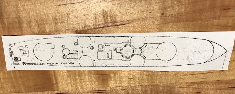

The shape is more of a bow kind
I just thought i can use a french ruler and do the cut and than snap it , probably that was the right way to do from the beginning .
I am not familiar with the material and i started with the proxxon and it was the worst things ever :)
i attached an example of the shape

David the plan I posted is for a small LCS , I will stick this plan on a very thin styrene and than apply it on a thicker piece of wood the shape of the hull is almost square so it will work out.
