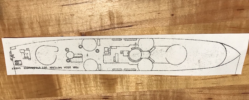

What is the best way to cut styrene sheet ?
While it’s very easy to cut it in a straight line , also with sheet thick from 2 to 4 mm or even more , the problem i am having is to cut curved line .
I first used a proxxon scroll saw , you can all imagine the mess I made , the plastic melted also if I set a slow speed .
I did search on the web for tip and also for videos that show the how/to but I didn’t find any useful.
Any advice is appreciated , Thanks
Daniele

Hi David
The shape is more of a bow kind
I just thought i can use a french ruler and do the cut and than snap it , probably that was the right way to do from the beginning .
I am not familiar with the material and i started with the proxxon and it was the worst things ever :)
i attached an example of the shape

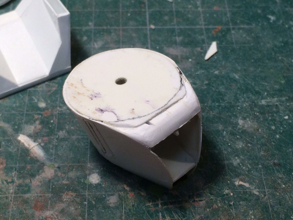

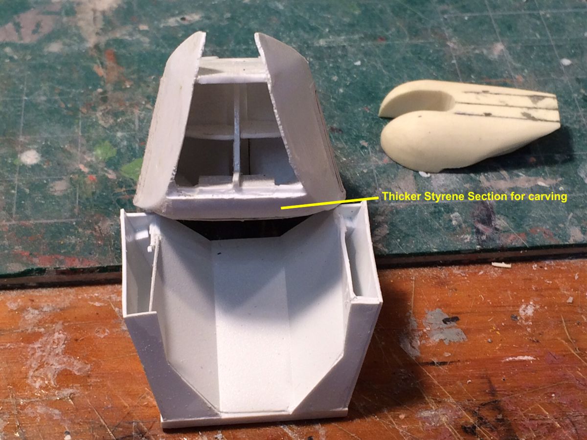

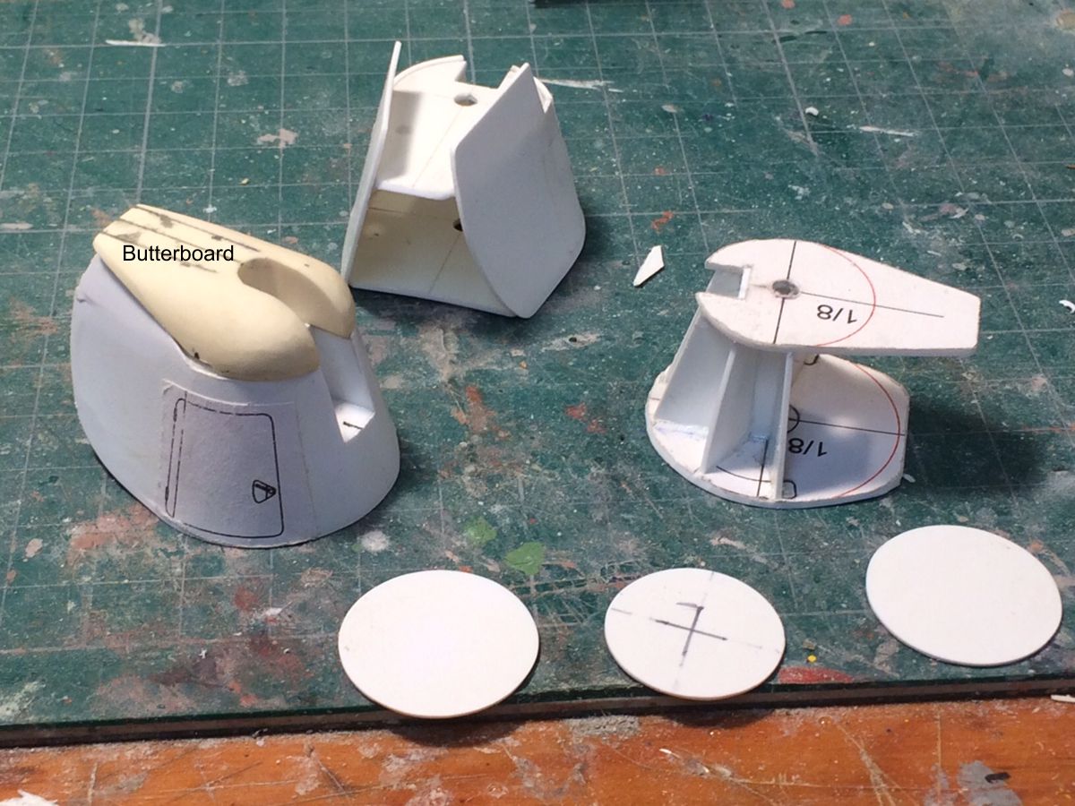

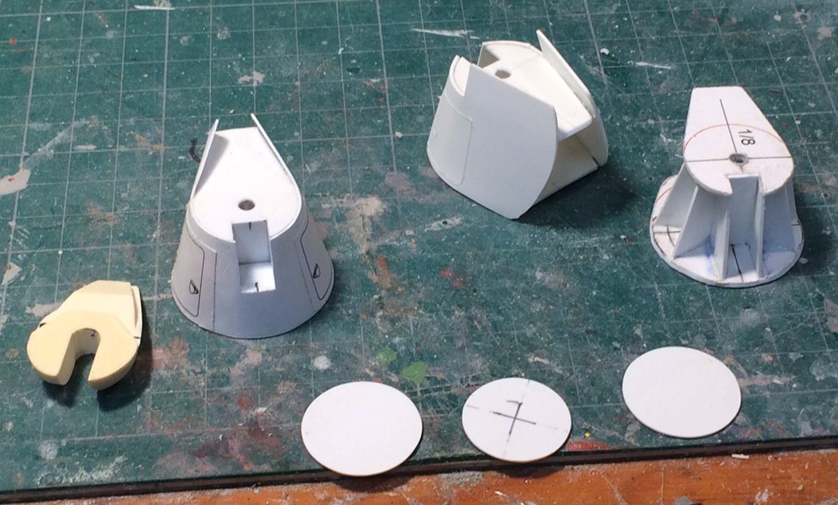

Here are some photos to show what can be done.
I've been working on a 1/96 scale 5" gun. It's about 1.25" wide and 1" tall.
In front are 3 disks I cut out using the snap method above. All the pieces are snapped out of larger sheets.
The Tan item is a piece of butter board, a dense foam resin material used by sign makers and professional model builders.
It comes in a variety of densities and carves and sands great! I'm using it for the top section that has a very curvy surface.
On the bottom rear, there is a section of thicker styrene where a curve needs to be carved/sanded at the edge.
The lines and markings are mostly removable sticker paper by avery that I have printed a pattern onto for a cutting guide. It peels off when no longer needed leaving the styrene undamaged.
These are test pieces and still pretty rough, but it wouldn't take much to finish them nicely.
The outer skin is one piece gently bent around the support frame underneath.
Darren (Admiral Hawk)
