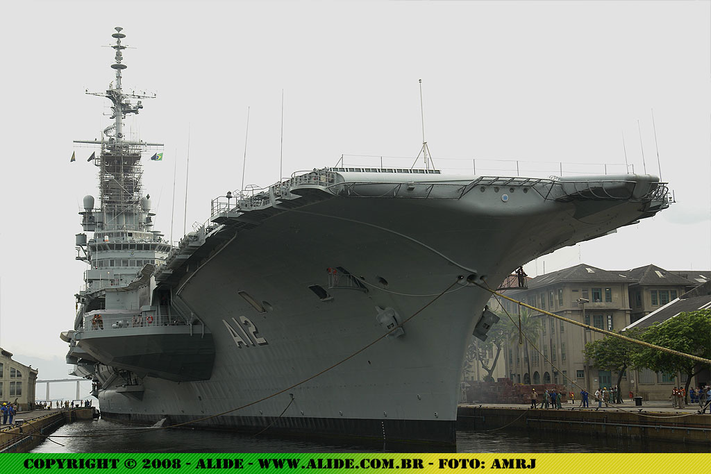

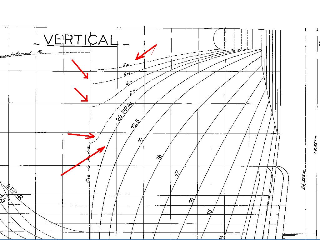

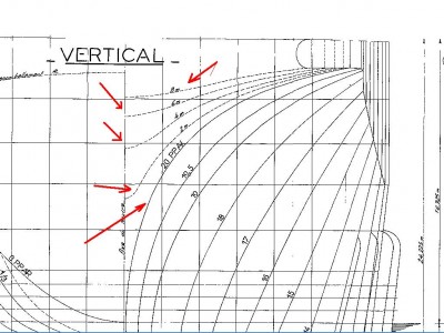

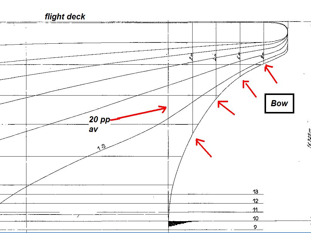

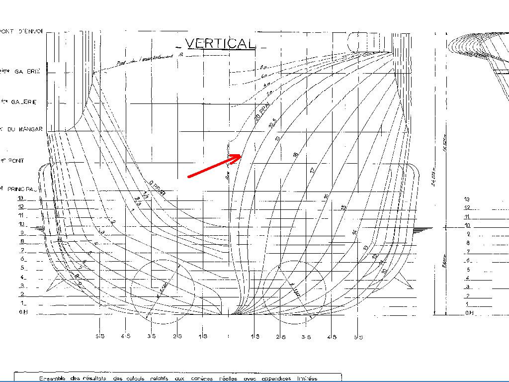

Very complex the design for the bow of an aircraft carrier.And this discussion may be very complex too!!!!........ The better to do is use a lot of lines to base the building and If your plan is very detailed the best you can get from it.
See the bow for an aircraft carrier in the following photo, BN “São Paulo”....... and them you can see the plan for the bow in 3 sheets........ pay attention for the hull lines pointed in red.......study these lines very carefully and try to “watch” them in 3d.......... I don't think the large front in triangle shape is FLAT, but this triangle in the bow is SPHERICAL and not that easy....................ask please someone to prove me wrong!
I don’t agree with Darren! :heh:
“””””The added problem of the carrier is the large flat front, you will have to put a cross piece on the top front edge of the keel profile and a flat triangular piece on the very front for the higher planks to attach to.””””””.............
:thumbs_up_1: :thumbs_up_1:
Nice regards: Jimmy
File comment: Nae São Paulo
File comment: general hull lines
File comment: detail hull lines
Make your influence positive!
Breton Fisherman's Prayer

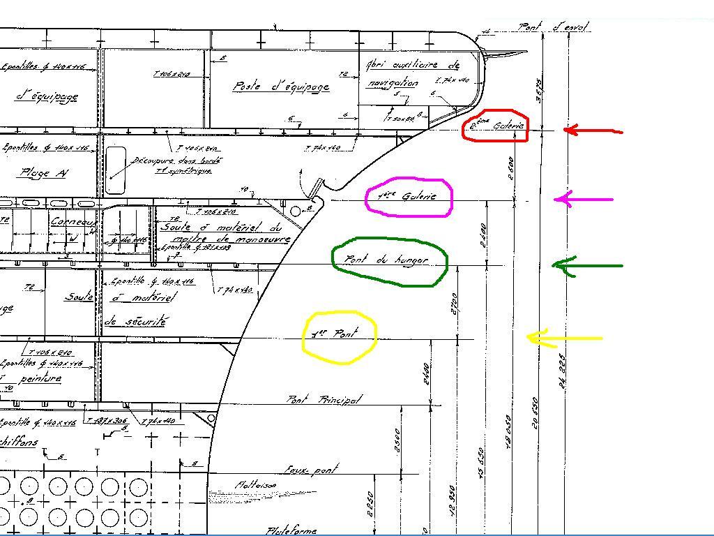

PostPosted: Tue Mar 25, 2008 1:47 am
Posts: 786
The third sheet......................
File comment: general arrangement bow
Hull lines as extracted from :
http://www.servicehistorique.sga.defens ... ......foch

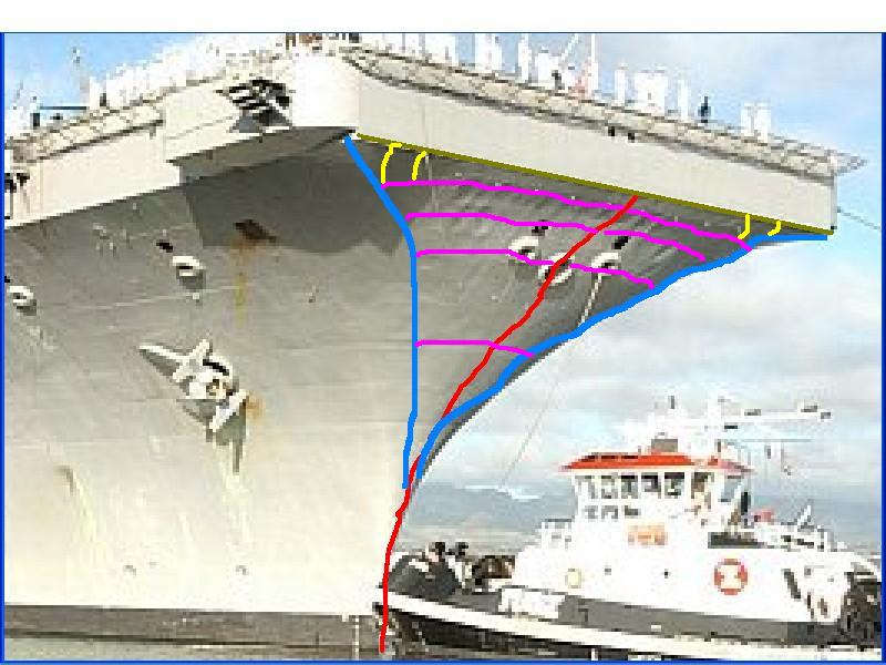

I did some other points with arrows in another view of the bow...see coloured arrows in pink, red, green and yellow that will have to “match” when I glue my planks in those places where I’ll put horizontal wood frames ........... if I begin gluing the central plank then I will go on this operation, “matching” the other planks to the rest of the frames................ these will be more lines to guide my planking.......... :thumbs_up_1:
But the triangle is spherical....not flat!!!
I mean that ALL LINES will be guiding the planks............that's my way trying the accuracy!
Nice regards: Jimmy

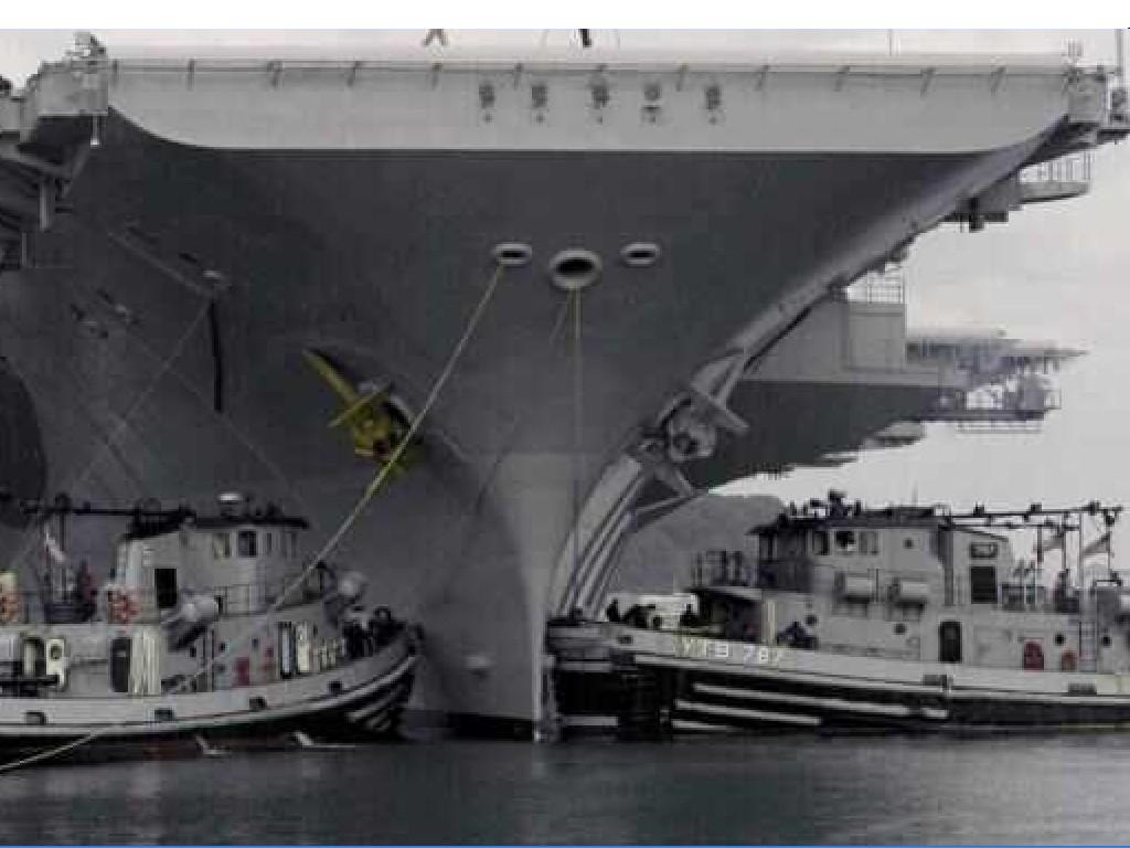

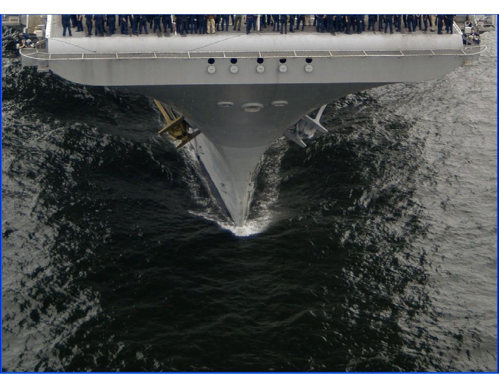

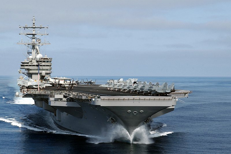

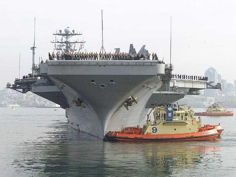

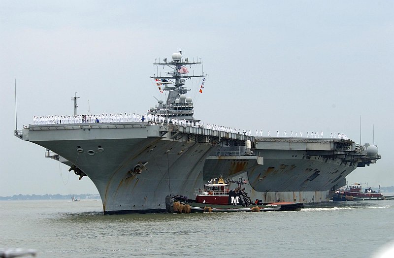

Bow shots of carriers, as extracted from Navsource..............

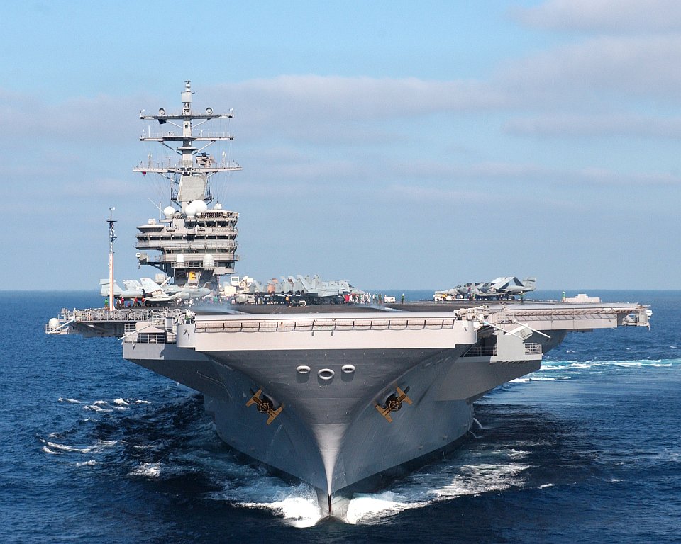

still...... Nice shots in Navsource!!!! :thumbs_up_1:

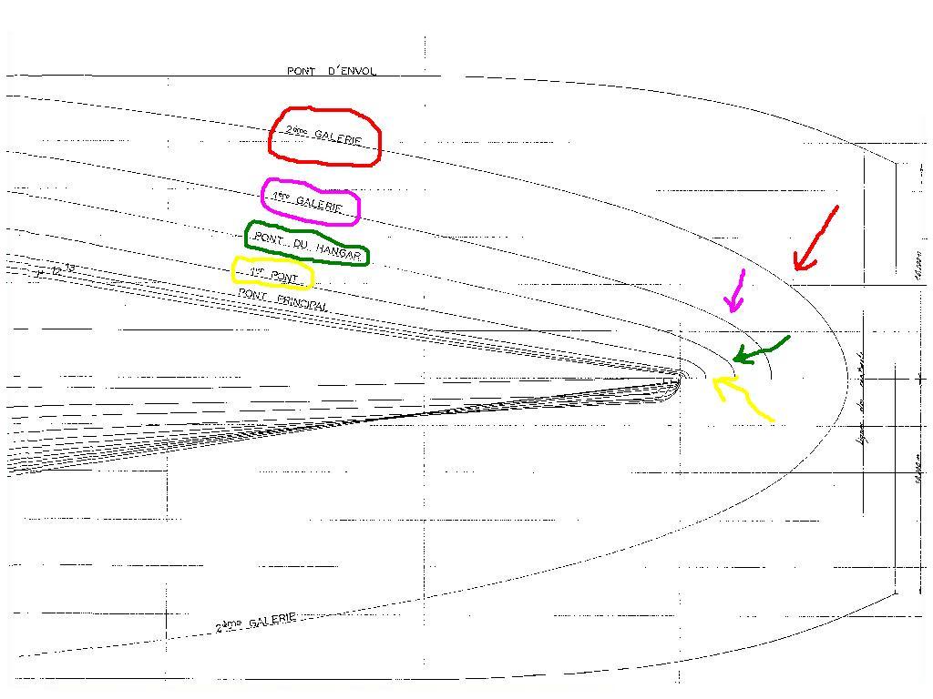

PostPosted: Wed Mar 26, 2008 10:58 am
Posts: 786
Maybe this discussion can be of help to Patrick.........

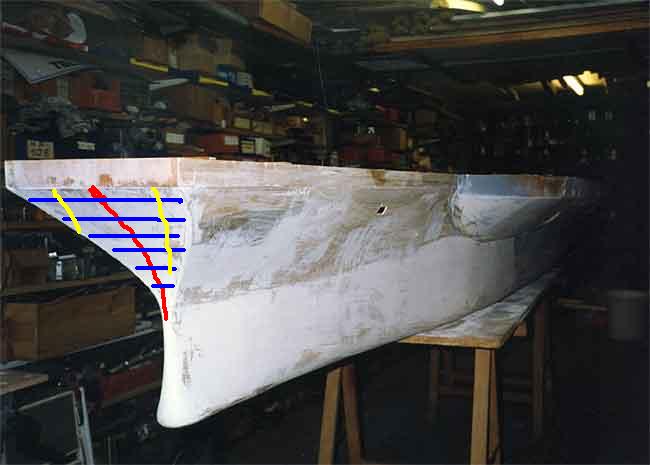

Next bow I think is wrong...... I put lines as I think are the "depths"......... The carrier that Claude is building is superb but seens to me that the bow is wrong........ the bow is with a bit of flat.............

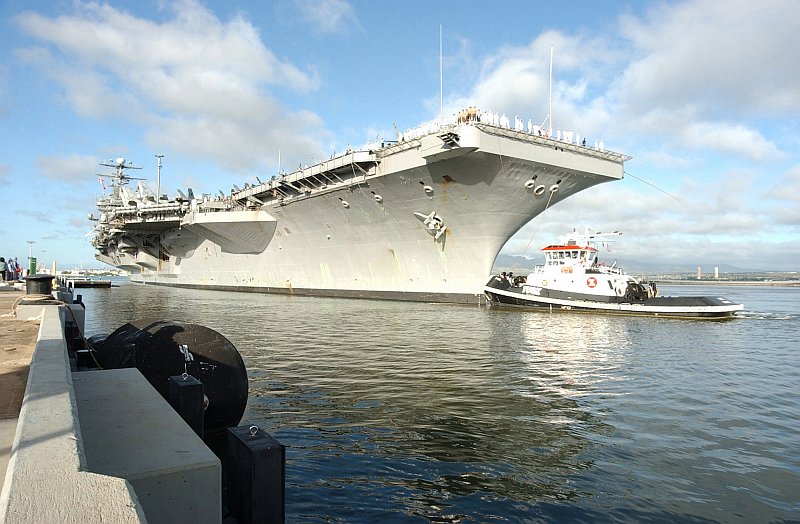

I post 2 more shots with different angles to help seeing the bow.....ship is USS “Kitty Hawk”........

PostPosted: Wed Mar 26, 2008 3:56 pm
Posts: 613
Hi Jimmy,
I wouldn't say that the model shown above is wrong. But I would say that the edges need to have more curve put into them.
I understand what you are saying, but I think it is matter of degree. Yes there are curves in the bow. But I don't see as much as you see. What I see is shown below.
In this pic of the Reagan, you can see a prominant weld line go across the front and some creasing from internal welding above it. To my eye, they go straight across for a large portion of the front. The red v outline is what I would call flat. The green circles are where I would use blocks/putty/sanding to make the sides curve into the front.
The following is a set of plans I got from Floating Drydock. They don't show the curves as much as I would like, but you can see that they are understated, rather than over stated.
Finally, even though I strive to make my models as accurate and detailed as I possible can, I don't expect others to. Modeling is supposed to be fun and relaxing so I usually make my responses lean toward that direction. If a model doesn't have quite the exact curve, so be it, hopefully someone had fun making it and is proud of it! :smallsmile:
Cheers! :wave_1:

Awesome shot of USS "Reagan" you posted ( do you have more??? ), and I can say is the best pic for this discussion. I like very much the green lines you put there showing the curves and the FLAT ( red) triangle, that is smaller than I inicially supposed you were referring to!!!
Our friends draftsmen put us in a big trouble co's we are discussing something that would be some solution for them to give us in drawings. As you do, I have too some hull lines for american carriers, exactly as you posted, and you can agree with the lack and deficiency of details to draw the bows. I'm analysing the words you sent me but right now got very tired and will be posting more later, and I'm here to let you know I'm reading this.................... :thumbs_up_1: :thumbs_up_1:
