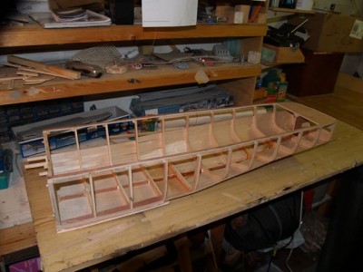

Despite the questions I have made a start on the model. The only way I could think of doing the Bow section was with sandwich construction - don't like this method - but with all the double curvature bits it appeared the only way. I think the method is to heavy - the lighter the hull the more you can get in, especially batteries - if you need ballast, use batteries!!!!
The Kuznetsov is, like the HST, will again be in two halves
The frame will now be roughly planked, wrapped in plastic and the inside painted with fibreglass resin before filling and sanding the outside to a good finish.
The small hull on the frame is the Italari kit used to draw scaled up plans. In the HST I used anchored nuts and loose bolts - thanks to boatman's suggestion I have used coach bolts and wing nuts - the simplest things are often the most clever !!

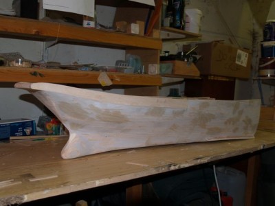

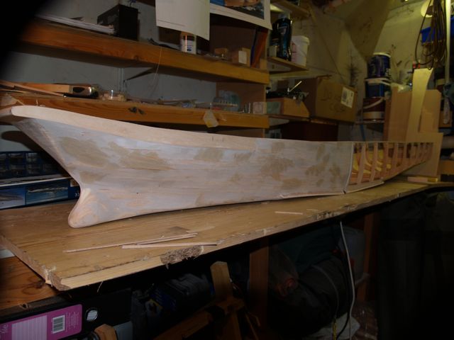

Just a couple more pictures of the hull build. I.m afraid I'm a little old fashioned with my hulls and stick to plank on frame. I know Fibreglass is the present favourite but it appears to be no easier and the end result appears to still require stiffening where the old plank and frame comes up rigid by the time half the planks are in place.
Bow section is just about ready for final sanding before undercoating and building a good finish for the top coats.
Unfortunatly the use of sandwich construction on the bow has made this section a little heavy at 4.25ibs with the stern likely to come out at about 3ib's, giving a total in the region of 8lb's for the basic hull. My HST required 50lb's of ballast to get her down to the waterline so a conservative estimate looks like being in the region of 40 - 45 ib's payload for the Kuznetsov. Should be enough for three 12 volt and two small six volt batteries and all the electrics.
I think the bow has come out reasonably well, although frame 2 turned out a little bit 'fat' but it wasn't to obvious until I had the planks in place - it will have to pass.
