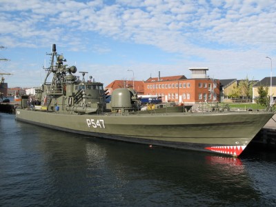

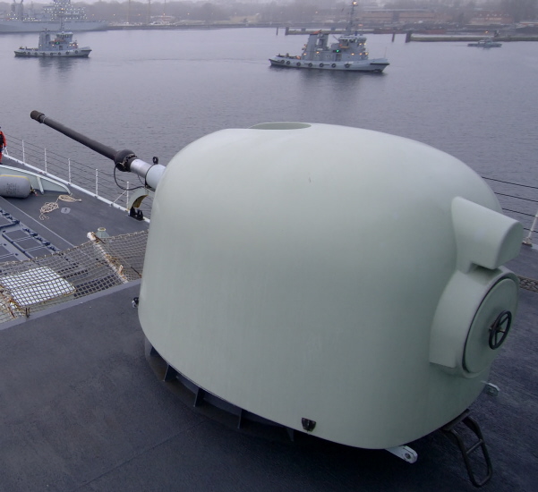

Hi, I am building a 1/50 scale Danish Willemoes FAC and would like some advice on building the unusually shaped deck gun.
Any help would be most appreciated.

Check this out.
http://www.navweaps.com/Weapons/WNUS_3-62_mk75_sketch.jpg
Some photos.
http://www.navweaps.com/Weapons/WNUS_3-62_mk75_pics.htm
NavWeaps is awesome when it comes to schematics! Hope that helps.

Hello Cliffy,
Thank you for the drawings, they will certainly help. Looks like it is going to take a bit of time to get that shape right as very few photographs of the gun even show the narrowing at the rear.
Thanks again Cheers GaryM

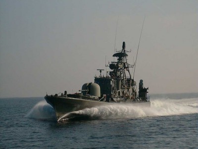

PostPosted: Tue Feb 09, 2010 11:39 am
Posts: 2432
Interesting project. I'm not even sure it narrows aft. I've been standing next to one and didn't quite notice any narrowing there...
Please show your project and how it's coming along, never saw a model of that class!

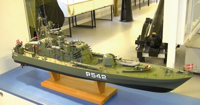

PostPosted: Thu Feb 11, 2010 7:44 pm
Joined: Mon Jan 17, 2005 6:19 am
Posts: 49
This is a model in a Danish Museum which attracted my attention and has started my research into the Willemoes Class

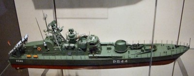

PostPosted: Sat Feb 20, 2010 2:48 am
Posts: 49
Thanks for the photograph, however the Willemoes appears to have an earlier model of gun.

PostPosted: Tue Jun 14, 2011 12:04 pm
Hi, I just saw this, and I can tell that the gun used on the Willemoes-Class isn't the one shown at the large picture, and I'm quite sure that the gun shown on the model, which I think could be from the museum in Aalborg, isn't the correct one too. All pictures I have found of this ship show the same gun, and according to the Navy informations the gun that was used on this wessel is described as the OTO-Melara 76mm Mk M/71 LvSa, and it's even different from the version that the Danish Navy used later for the Standard Flex Class - even if they look similar.
I do write this too, just to hear how the project is developing?
I've seen the model at the museum too, and I've previoulsly often seen the ship in the harbour of my town, and for quite some time I've been lokking for prints as I would like to build this ship, but I had no luck, so how did you manage?
