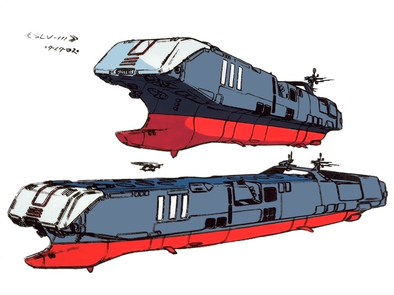

Note: no running gear (props, shafts, or rudders!) Now you know why the lack of information :big_grin: I would give it the same speed as modern warships, 30+ knots.
http://www.macrossworld.com/macross/art/mcr374l.jpg
Thank you everyone. There are two shrouds in the back, so propulsion would have to be in pairs, either two props, or four. Three won't work. I'm thinking four 500 sized motors would be enough power.

the top half of the ship will have to be made of light weight materials or your center of gravity has to be low as she will capsize easily
 Post subject:
PostPosted: Fri Feb 17, 2006 3:45 pm
You got that right ddp! The bottom is being made out of 2 and 3mm styrene (lots of it) and the top will be much thinner. In fact, the lower hull will act like a skeleton so I can thin out the top. Two massive 6volt batteries should help ballast it out too :thumbs_up_1:

Posts: 70
going by the picture, the water part of the hull is narrower than the top part of the hull so will have a stability problem unless waterline was raised til bottom of overhang of upper hull

I understand. I'm just going to build it like an aircraft carrirer (those have massive overhang). The main part of the hull is flat bottomed, so that will help. The overhang will only be an inch on either side, so this shouldn't be a problem. Unlike a battleship, this won't have much detail on it topside so I'm sorta cheating there.
