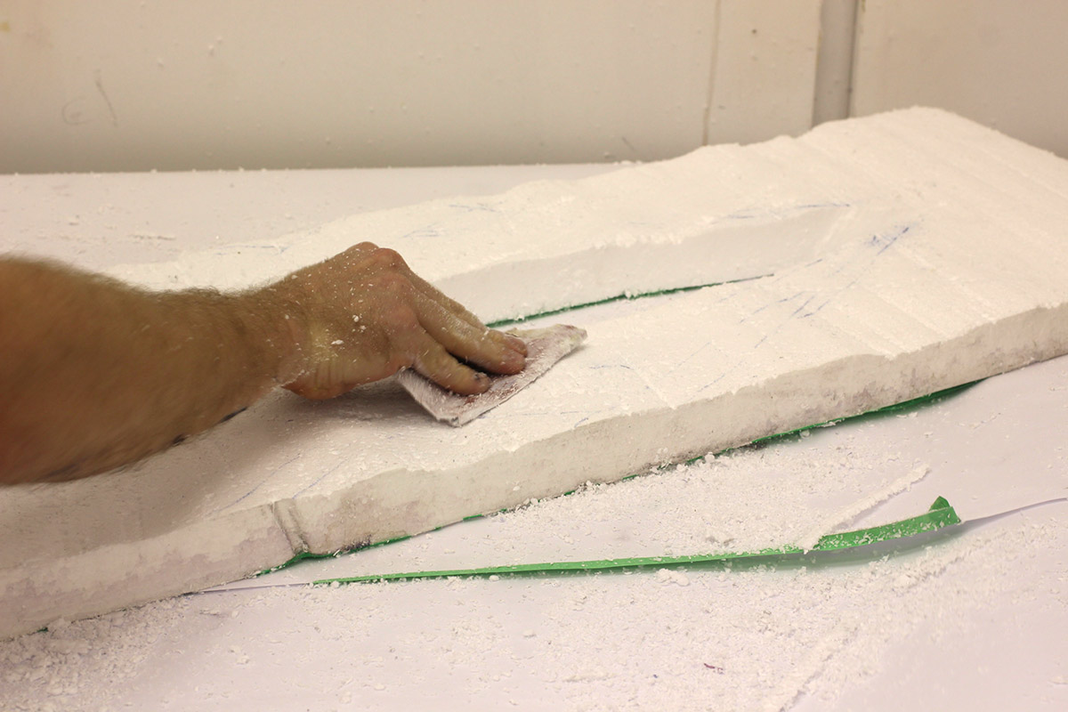

It is now easy and fun to use my large tube covered in sandpaper to shape and smooth out my hacked-out contours. There are many uses for my sanding tube.
The overall form is coming together and smoothing out.

Using coarse sandpaper, I add refinements and continue to shape and smooth out the form.

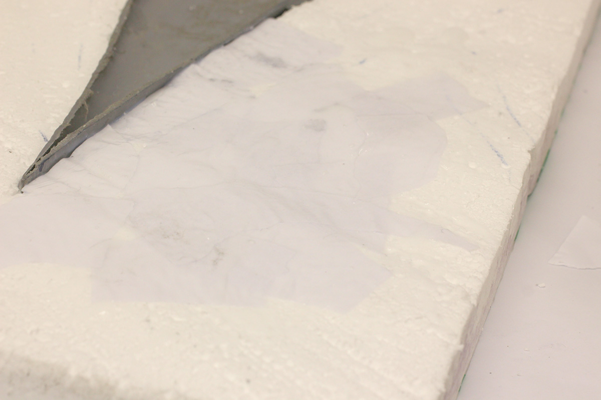

First I brush down generous amounts of medium, place the paper down, then brush more medium on top.
The paper easily spans any gaps between the hull and the foam. You can be very precise and create a super flush look.
Here you can see how the bits of paper overlap each other and create a single, smooth surface. They conceal any holes and styrofoam texture.

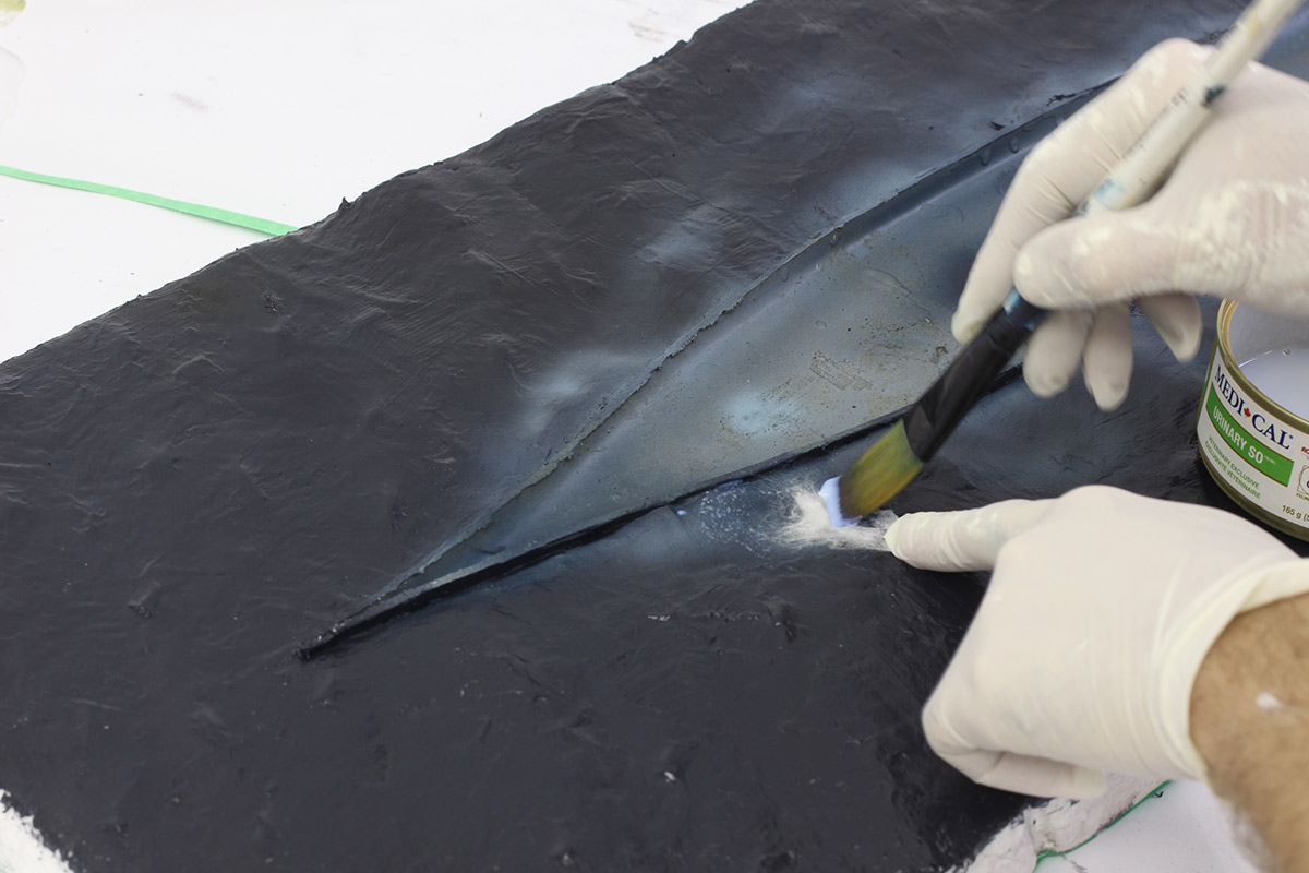

Here I have gone in with the lighter minty color. I've more or less built-out from the darker color. It's as if the minty color is moving down into the darkness of the base. This is the illusion you want.
Here I have completed the painting of the sea. I found that I overdid my minty colors and have gone back over it with a bit of thalo blue and black airbrushing to knock it back a bit. Subtlety is more realistic with this minty color I find. FIX YOUR AIRBRUSHING WITH AN ACRYLIC MATTE MEDIUM BEFORE MOVING FORWARD! If you don't, the airbrushing can reactivate and start contaminating your cotton work.

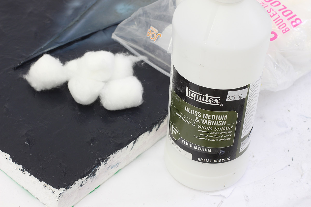

After the minty color has cured, I am now going to create my whitewater effects with regular medical cotton balls. Be sure the brand you use has no seeds in it. This is important: some cotton balls are made of cotton, and some are made of Rayon. The Rayon balls are way better than cotton. If you can find these, they're awesome for doing wakes.
You can easily pull them between your fingers to create web-like sheets that you can glue down.
I am using gloss acrylic artist's medium to attach the cotton whitewater. I first brush down some medium, place my cotton pull, and brush more medium on top.

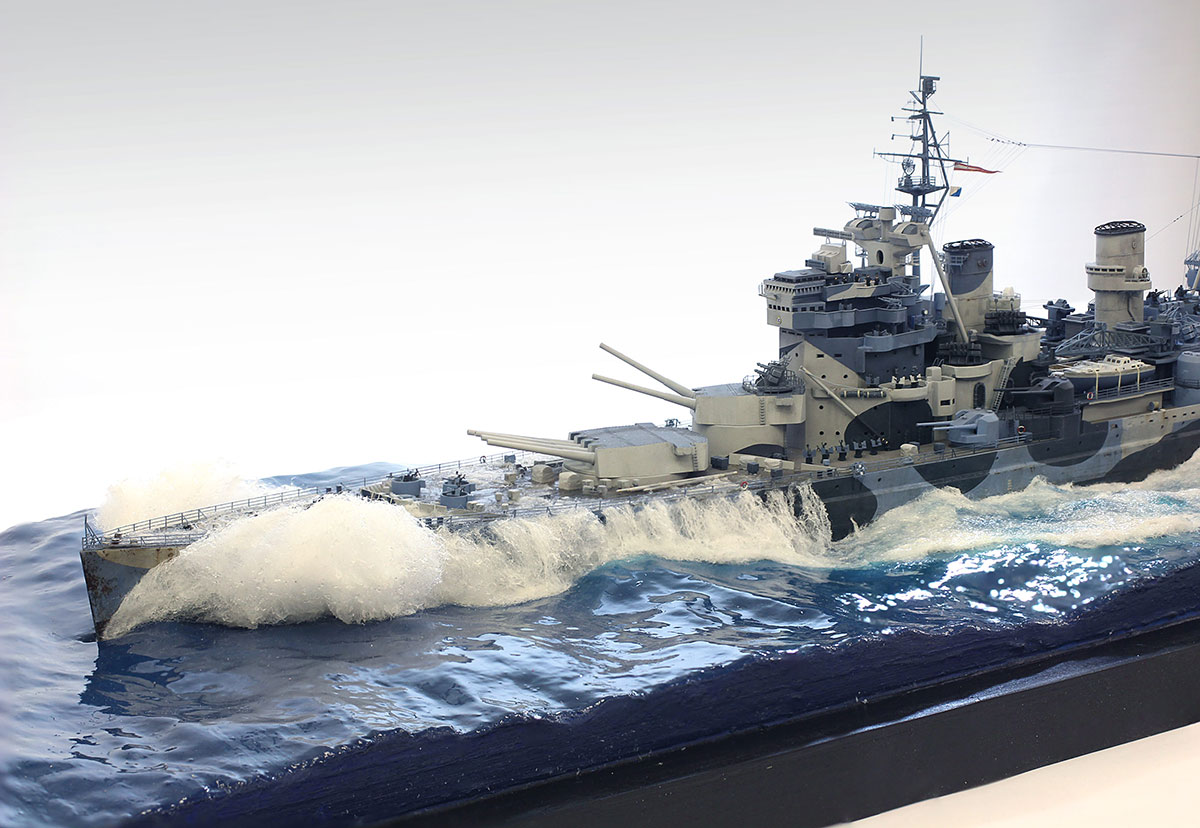

Here is the final sea...Not the greatest as it was quickly done for this demo but it basically shows what I do.
This HMS Howe was done exactly as per above. As you can see, I did not not and add gel medium waves to the paper layer. What you're seeing here is just paper that has been thoroughly coated and sanded. I then painted it as per above, did my cotton stuff, and applied several coats of Liquitex HIGH gloss medium
