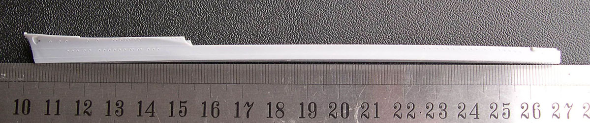

Finally figured out the picture posting!
http://i.imgur.com/TXzSk5n.jpg

I still don't get why mine isn't hogged.
I was really dreading this, and then got my kit, and noticed "HEY! No Hogging!"
Relieved, to say the least.

Very interesting. Possibly the early kits came out of the mold to soon or the mold temp was too cool. Just speculation of course. The two hulls I "fixed" were ordered on reserve from Hobby Search very early.MatthewB wrote:I still don't get why mine isn't hogged.
MB

If it is true that Yamashita has managed to tame the hogging, then this kit is a must-have for the Fubuki class fans. I, too, wonder what it is they might have done. Maybe increased the cooling time before ejecting the kit from the mold.
'tis my kit that Steve fixed (thankfully) and his methodology clearly works (below). A hullsmith if ever I've known one.

I jinxed myself by bragging that my Yamashita Fubuki had no hogging in the hull.
Because I got my Aoshima IJN Takao last week, and I opened it today to take a look at it.
The hull is MASSIVELY Hogged.
I am going to try this method to un-do it. But it will be at least Tuesday before I can, do to needing to buy the clamps and aluminum angle stock.

This technique worked for me on a 1/700 G37 Flyhawk model. Thanks for the tip!.
