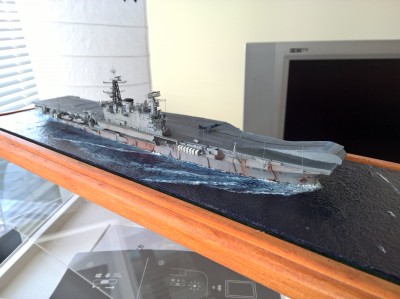

An unusual method that I discovered was to hairy brush the sealing varnish in the same direction of the weathering pastel. I did this for my Hermes' hull and it came out better than I had feared! If you do want to use this method on purpose, be sure to under-do the streaking before applying the varnish, since the brush strokes will pull the pastel powder in the stroke direction.
