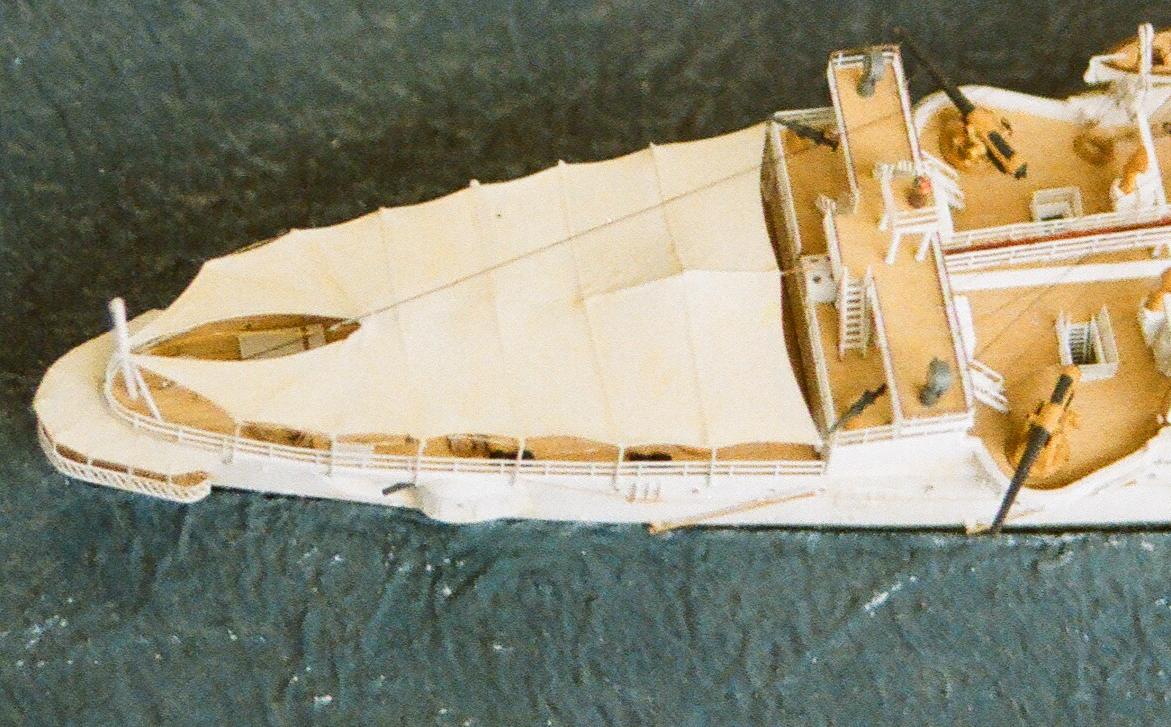

What is the best way to build an awning at the stern (for my Combrig Renown)? I'm pretty sure I've seen somethings here, but can't seem to find anything. Any help or links would be greatly appreciated.

Jim B does them with supports built of stretched sprue and/or wire and then stretches a layer of white glue between the frames to make the canvas.

How large are you thinking? I did the entire quarterdeck of my BB-63 using this method, though making sure that I had plenty of framing: http://www.modelshipgallery.com/gallery ... index.html

Hi Timmy,
Wow, great job! Yes, that is about the size I want to do.

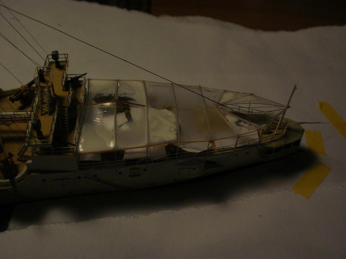

Following Master Bauman's lead I also tried the white glue method on the Varyag in 1/350. I am including some pics of the process as the white glue sets to give an idea of the areas that can be covered.
The reason I am posting is to draw attention to an effect found by serendipity. If the sides of the frame are very thin stretched sprue, the tension exerted as the white glue sets draws them in giving them a nice curvature that renders the stretching of the cloth along the edges. More comments on the pics.
File comment: Here you see the frame and the white glue setting on some of the sections. Note the pieces of paper a I spread on the deck to protect it from accidents. They were not needed in the end. Even if the glue popped open a hole, it stuck to the frame.
File comment: Here the glue has set and the tarps have been sprayed with matt varnish; quick passes with paint landing almost dry. You can see the curvature on the periphery of the cloth and especially at the stern where it makes room for the back-stay to come through. Doing the part where the back-stay goes through came as an afterthought, once I realized that the tension creates the curvatures at the edges. Also note the "botched" section, third from left on the port side: I fiddled with it as the glue was setting. Lesson I learned: do not do that!
File comment: Here it is painted, before getting it "dirtied". I liked how the curvatures convey the stretching.
