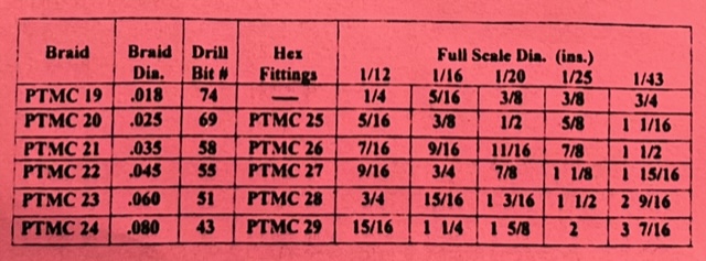

biggles2 wrote:
Does anyone have any suggestions for modelling rolled up (stowed) anti-torpedo nets in 1/700? I thought of suitably sized thread or string, but they just don't have a netting texture. I will take a look at nylon stockings, but I think the mesh might be a little coarse. :wave_1:
You might want to look at braided hose line that car modelers use. Comes in a variety is diameters and gives a nice even rolled appearance for anti-torpedo nets.
-- Scott
