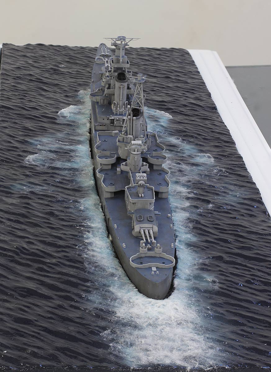

I've tweaked and changed my ocean methods quite a bit over the past couple of years. I have worked very hard to develop these strategies so that they conform to the following criteria: Cheap to make, easy to do with easily acquired materials, permanent, fast, non-threatening to the finished ship, and realistic. Here is my USS Wisconsin build that uses the walled-off oat method (below), covered with paper towel and finished with paint, airbrushing, and rayon cotton batting. While I probably wouldn't do a sea with oats these days, the basic concept of covering a textural surface with paper or paper towel to 'bridge' the texture is the key to my wavy water. Ultra calm water requires slightly different approaches. I've tried to lay everything out as best I can in the following links and tutorials.
As far as I can see, a sea has roughly three aspects to consider: The overall sculpt of the initial sea form, The surface treatment of the sea (wavelets, waves etc.), and the painted finish including wake effects. Each one of these aspects has to be convincing in order for a sea to look realistic.
INITIAL SCULPT
I've done sea sculpts in a variety of ways. I've used plaster, oats and CA glue finished with paper(below), and carved styrofoam, also covered with paper (links provided, also illustrated in this thread).
Plaster is outlined here, though I would never do water this way these days: viewtopic.php?f=4&t=156538
Styrofoam Here: viewtopic.php?f=4&t=157503&p=637868#p637868
Very calm water with wake swells here: viewtopic.php?f=4&t=158909&p=651903#p651903
Oats and CA is outlined below
While each approach can work, I've come to the opinion that styrofoam is the most versatile and easy to work with for any sea condition. These days, I'd do my sea by first carving foam. I'd do the entire sea before attaching the ship. Any cracks along the waterline are easily resolved with more cotton. I outline this in the links above.

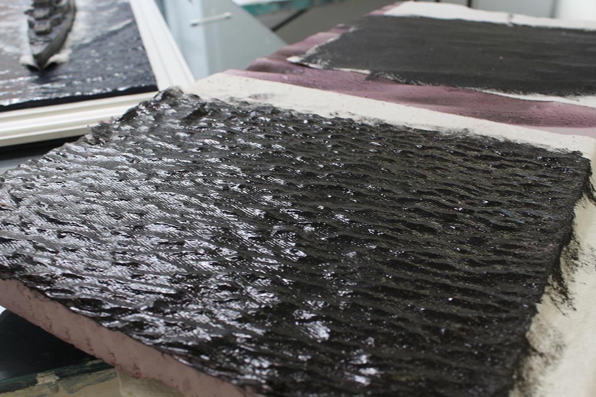

SURFACE TREATMENT
I've come to believe that smoother is better for a sea surface. Everything has to be smooth, undulating and free of un-wavelike lumps, grits, cracks, inconsistent 'waves' , pin holes, brushy daubs, and other such tells. I've had a great deal of success using small pieces of regular paper or paper towel that are glued down with either acrylic clear medium or aerosol spray adhesive over the sculpt, be it foam, oats, or whatever. I outline this process here viewtopic.php?f=4&t=157503&p=637868#p637868 Sanded smooth, the overall effect is quite naturalistic.
I've experimented with attempting to fill a lumpy surface with some kind of filler, but nothing works quite so well as collaging paper and acrylic clear medium over a rougher surface to create that smooth undulating effect. I do lots of sanding and nit-picking these days to get it perfect. Coarsely carved styrofoam that is sanded, then covered with paper is probably my most favorite and more successful efforts at making a sea. Many different effects can be produced by applying paper or paper towel to a coarse surface. My HMS Howe and Zerstorer are good examples of this. It's really become my go-to process.
For thousands of wavelets, it is possible to lay down a rough surface of oat bran onto a glue layer, let it dry, then glue paper towel on top of it regardless of how your initial sculpt was made. Here is a link to that specific idea: viewtopic.php?f=4&t=156536 . Coarsely carved styrofoam that is then covered with paper or paper towel produces the same sort of effects and is more elegant in concept. For a very calm, breezy wavelet look, you could simply use some kind of small tool to make thousands of little dents in styrofoam and finish it with a single sheet of paper towel applied with spray adhesive. After many coats of paint, the look will be very convincing.
For a very calm sea, I've used plaster that I blow with a straw. My Graf Spee was done this way. http://www.modelshipgallery.com/gallery ... /index.htm To be honest, making a sea with a wet material like plaster is messy, risky, and too wild to produce perfect results. The concept of blowing plaster is kind of cool and might work for certain people though.
While plaster can work well for a very calm sea, I again have to say that styrofoam that has been carefully cut and shaped and sanded to perfect smoothness is still the better way to go, followed by a texture treatment. I've been experimenting with a perfectly smooth surface that is first textured with acrylic clear medium then painted. This can work very well for calm water and is outlined in full here: viewtopic.php?f=4&t=158909&p=651903#p651903
PAINT FINISH AND FINAL GLOSS
I always paint my seas the same way. I first paint the entire sea a single ocean color, then I go in with an airbrush and a minty color to do the sub-surface aquamarine churn. I have experimented with many different ocean colors and have settled on one specific color that seems to be the most realistic for both photography and real-life presentation. I always use a mixture of black, white, and thalo blue. First I mix a bit of white into my blue to lighten it, then I add small amounts of black until the color approaches something like a blue-jeans hue. For my sub-surface churn, I use a premixed turquoise green that I then add a bit of white to, followed by a drop of black to grey it a bit. I then use acrylic gloss medium and medical cotton puffs to create my whitewater effects. I outline that all here: viewtopic.php?f=4&t=157503&p=637868#p637868
As a final gloss, I use Liquitex HIGH gloss acrylic varnish. My Prince of Wales received something like 15 coats of it. It's easily as shiny as epoxy, but permanent and non-yellowing.

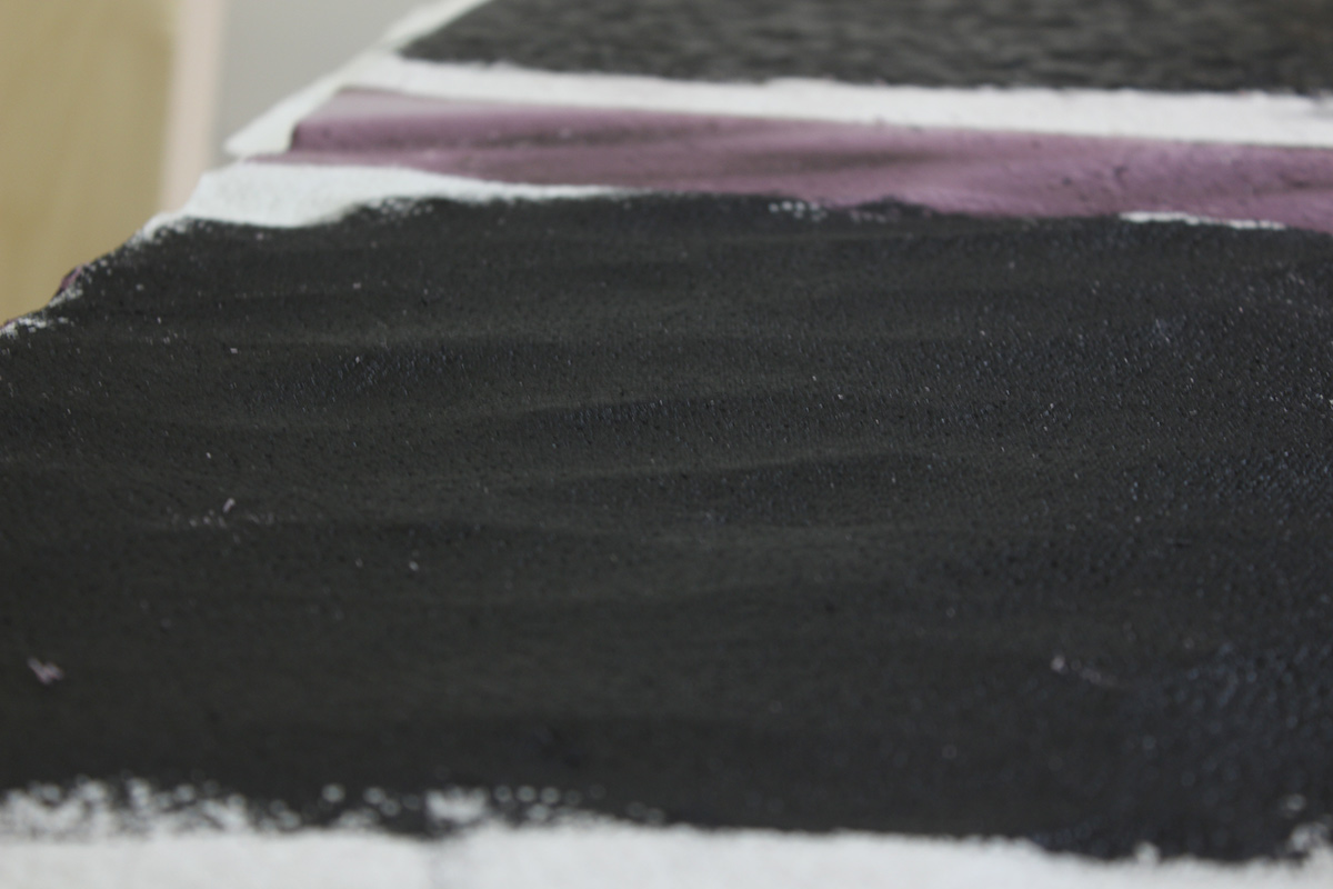

OAT METHOD
A warning and strong bit of advice regarding the following procedure, please take note:
Once your oats are frozen in place, it is absolutely critical that you sand the resulting surface until it is as smooth as you can make it. You don't want strange oat bits sticking up, exaggerated lumps, or anything that is out of place. Spend a good 30 minutes sanding your surface until it has an undulating evenness about it. I do not recommend simply painting or applying gel medium to the oats to finish them. It won't be enough and the final look is nauseating to the viewer. The texture must be resolved by filling in the texture. The best and easiest way to do this is by collaging small paper or paper towel pieces onto this surface. The paper will bridge the gaps and produce a very convincing undulation. Here is a link that shows the process of coating a rough surface with paper/paper towel. viewtopic.php?f=4&t=157503&p=637868#p637868

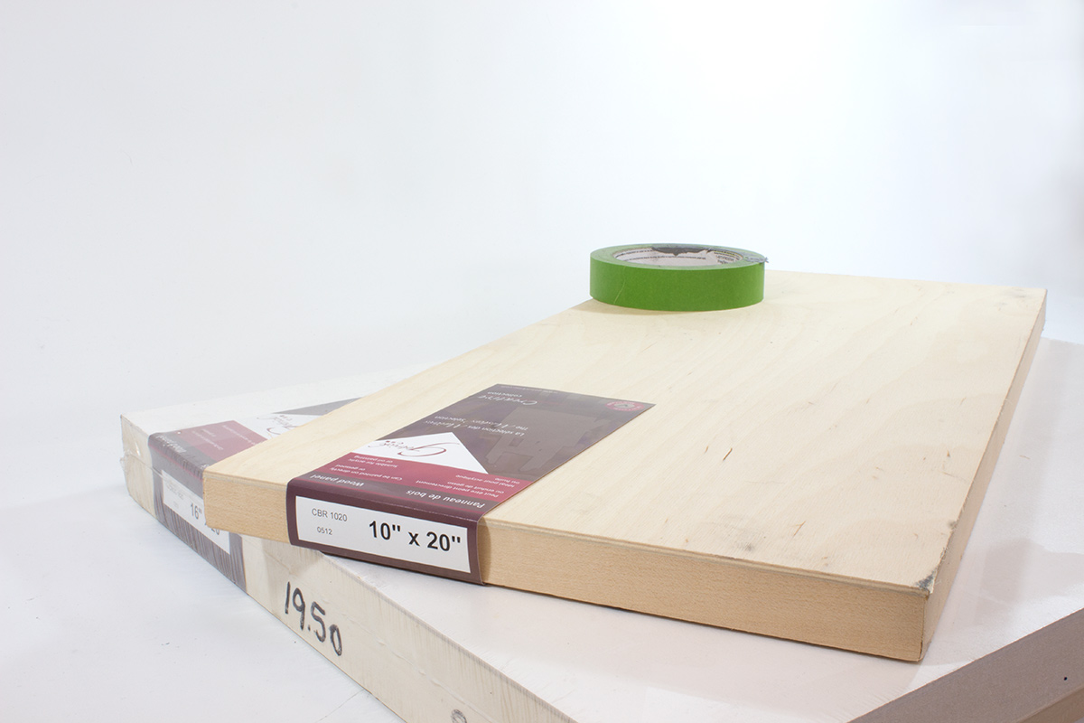

This is a method for making the initial sculpt.
The principle is simple. You take oat bran, shape it until you are happy with it, freeze it with CA glue, sand it, and resolve the surface by collaging paper or paper towel onto it.

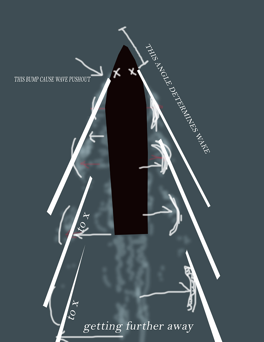

For a more comprehensive description of how I do my whitewater and wake look here: viewtopic.php?f=4&t=157503&p=637868#p637868
To be really honest, no two seas that I make are exactly the same. http://www.modelshipgallery.com/gallery ... /index.htm. I tweak my methods and try different things from build to build.
While the method below can work really well, it's not without its drawbacks such as the need for bulk CA, the hassle of having to protect the hull, toxicity, and the cost of the materials.
The idea of freezing a dry substance in pace is nice in principle. I've had good luck with it making general landscape forms as well as seas. My Graf Spee diorama as well as my Heian Maru dio were made with oats and CA. http://www.modelshipgallery.com/gallery ... /index.htm
The landscapes were made by mounding oats in walled-off areas and simply hitting them with CA. Once cured the oats are sandable and really tough.

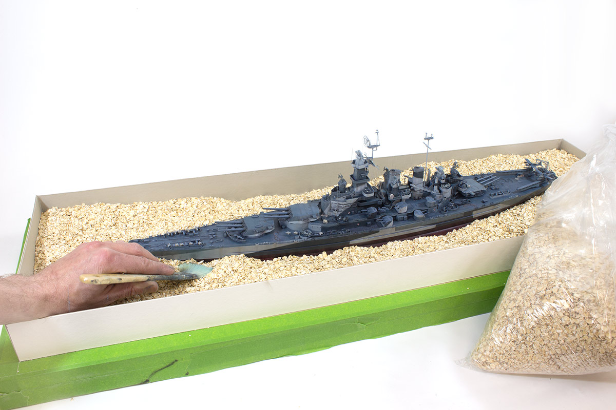

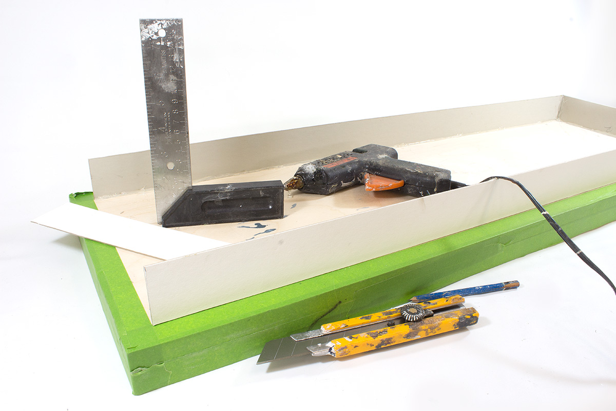

- I dump bulk-purchased dry OAT BRAN, (not regular oats) into the walled off area. NOTE: THESE PICTURES SHOW ME USING REGULAR OATS, BUT I'M FINDING THEM TO BE A LITTLE TOO COARSE SO I NOW ONLY USE OAT BRAN. Using my hands and a flat brush as a tool, I manipulate the oats until I like the look. I love that I can do this indefinitely until I am fully satisfied.

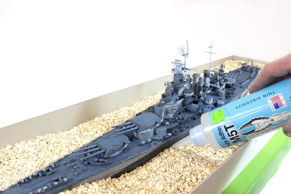

- Using a bulk amount of CA glue that I can get easily where I live for about 20 bucks, I carefully squirt the CA onto the oat surface. I am careful to get every square inch soaked. I squirt liberally along the cardboard perimeter where the oats meet as well as along the hull. I have had some minor issues with frosting from the CA. The only time I've had serious frosting was when I did this with sawdust outside on a cold day. Sawdust will produce smoke as it cures which can fog the model. Oats do not do this hardly ever for some reason. Any fogging that might occur can easily be removed with paint thinner. If you try to protect your ship, be wary of the possibility of the CA running up and into your mask and bonding the masking tape or whatever to the ship. Bad scene.

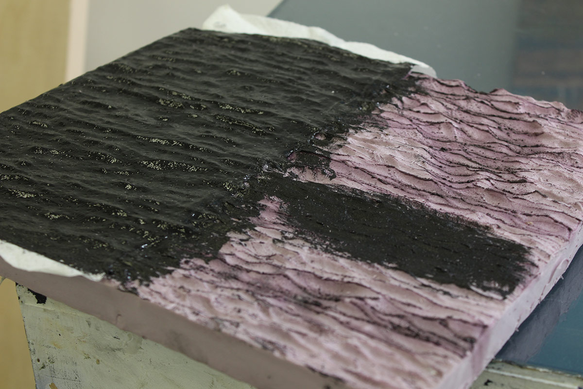

As I mentioned above, foam is my go-to process these days. For every type of sea condition where waves are present, it is possible to carve foam in such a way so that when it is covered with either paper or paper towel, the result will look convincing. Below are test examples of different foam carvings that have been covered with paper towel.
I have recently discovered that it is very easy to simply glue down one long piece of paper towel by first spraying aerosol contact cement to both surfaces, waiting for it to get tacky, then pressing the paper down. After thoroughly buffing the paper towel with your hand and fingers, it will take subsequent paint layers without wrinkling. Wrinkling should always be avoided as it a dead giveaway that can ruin the overall effect.
- Here is a dremelled foam base, covered in a single length of paper towel. I used aerosol contact cement to attach the towel. The towel went right over the ship's hole and overhung the edges. I trimmed it after I glued it down. It was ready to paint instantly. I applied about 10 coats of artist's gesso, followed by my sea color and minty green airbrushing. After the cotton work, I applied about 10 coats of Liquitex High gloss varnish.

-I use gloss, extra heavy acrylic gel medium to coat the oat surface. i sand the surface first, then lay it on very thick, being careful to make it water like. Once it's dry, I'll add more to make sure the oats are very well buried.
-Yes, i use crazy glue . THIN viscosity that I buy bulk from Mercury adhesives
-Oat bran is basically just the husk of a wheat grain or something to that effect. I'm assuming you are from the US? I find that Americans don't know what oat bran is�it must have a different name down there. It looks like you took quaker quick oats and but them in a blender. It's a finer texture
