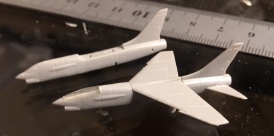

Hi, no nothing that complicated I simply mix the mold putty and then press the aircraft nose into it making sure I get the whole canopy and then cast it, it needs to be cleaned and sanded on the bottom if you used to much but then I cut off the old canopy and install the new one.
I have included a pic of one of the aircraft I'm working on.
