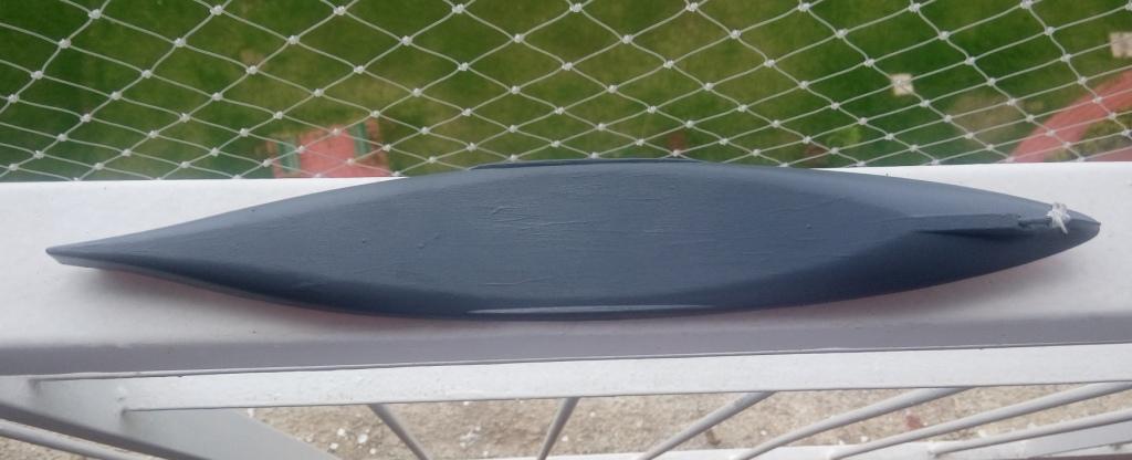

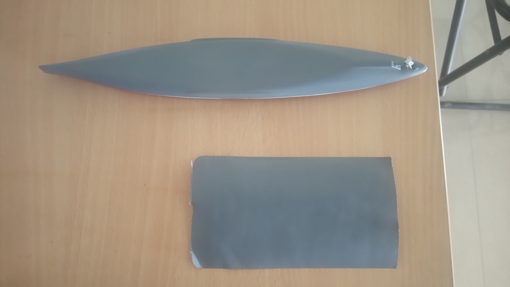

Its amazing that I've been using the same principles to paint ships for years (1:1 scale) and didn't know the theory behind it.
I mixed up a DKM dark grey for the Bissy hull. I think I might have gotten the color right, but the shade is off. What do you think?

Thats the best primer out there!

I can't comment on the accuracy of your color.
