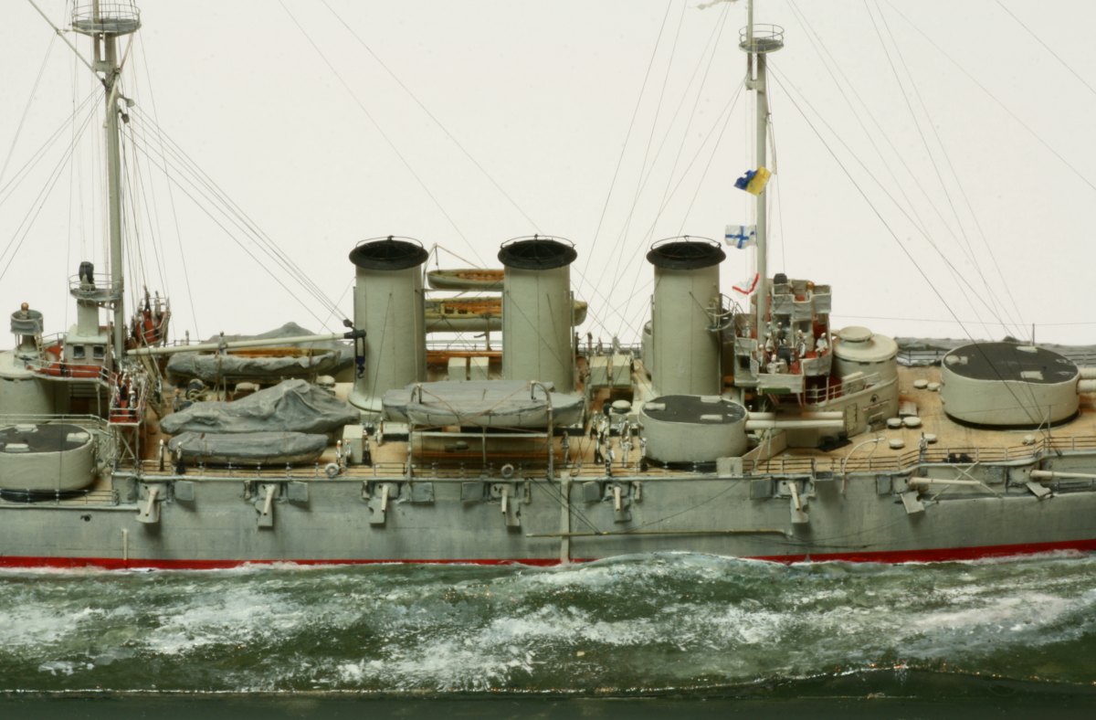

hello Tan 63
Biggles is correct, that in 1/700 any depiction of eybolts or similar is likely to be way over-scale.
so a 'butt-join to the deck in small scales will be close enough
Signal halyards( which are in effect usually endless via clip-to-flags on the other hand were often secured to the railing with a clove hitch knot
again in 1/700 mere contact with the railing will be within scale
My rigging method was mentioned earlier--I use stretched sprue
Have a look here at the step-by-step
viewtopic.php?f=4&t=37536
Stretched sprue is about as thin and fine as you can get.
http://www.modelwarships.com/reviews/sh ... na_006.jpg
more here
do feel free to ask further questions -
specifically which ship are you building?
best wishes
JB

Thanks for the pic and may I say a lovely looking model.
I'm sat here now thinking what have I let myself in for,lol.

I'll throw in my two cents on this (as I have done before) Honestly , the "1/700" rigging suggested above is just too thick. Look at Jim's ship. The rigging is much finer. The rigging on your ship should not be visible from more than a couple of feet away. Otherwise it's just over scale. At the end of the day, work with whatever you are comfortable with and what your skill level (and eyesight) can cope with, but remember - when it comes to rigging, less is more.
