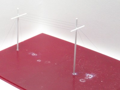

Got my camera back so I thought I'd post some pics of my test rig of the Caenis thread.
Dave :wave_1:
