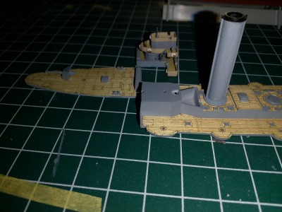

See attached profile photo.
I placed forward turret, bridge, funnel and rear platforms in their respective fittings to give you an idea.
Thanks drasticplastic, I will see what Darren's proposal is first :wave_1:

First, photos can lie. Perspective is everything and can make things look way different than they are.
Second, Kits always have flaws.
The Photo you provided is good, but it's taken a little too close to make a perfect comparison. However, I think it shows enough to identify the issues.
In this comparison, you see that the kit is off in several spots. To fix the funnel spacing means moving the first 2 funnels forward. However, to do that properly, you need to remake the structure they stand on. That's a lot of work and might be more than you're willing to attempt. Also, if you are going to fix the funnels, then you may as well fix all the other little issues, like the side gun sponson placing.
What I think might be a better solution, is to extend the deck that the bridge structure sits on and move the whole thing back a little. In this photo, the white box shows approx how much you could add to the front. You could move the funnel a small amount forward if you wanted without major surgery. Then, when the vents are put between the bridge and funnel, the gap will be much less noticeable.
I hope that helps a little, whatever you decide to do.

Thanks for the analysis Darren. I still don't really understand. Do you mean bringing the bridge back like in the pics below? (cutting the long piece on the foredeck and moving that back as well) Have to take care of that wall ending on the main deck, where a stepladder goes on either side.

Close.
leave the main deck the way it is.
Extend the deck above by cutting the block and moving it forward.
You will also have to extend the side blocks and the deck itself to match.
Then the bridge will sit closer to the stack like you have it in the last photo.
Not a perfect solution, but it may save you some work and look reasonably decent.
I can draw you a cutting guide if you'd like.

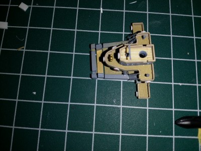

Ok so I've made a good attempt at this but it still looks very rudimentary. I bought grooved styrene which looks close to deck planking, cut a length of that and stuck two pieces of thick styrene on the ends to represent the bulkhead borders. Painted it and this is the end result. Haven't glued it together yet because I don't like it. It doesn't look right because the rest of the deck around it is mesh flooring. Any level of scratchbuilding is really beyond me unfortunately, all I know is how to stick pieces together and paint them.
I could make more attempts, but I can't replicate that mesh decking and without that the scratchbuilt piece will stand out by a mile.

I think your "mesh" flooring is actually a criss-cross wood planking on the deck. In any case, you put your replacement decking running side to side instead of fore and aft as deck planking should usually run. If you've still got the scrap wood from the decking sheet you can cut out a piece to cover the entire area (original and scratch) and draw on a grid with fine point pen, or pencil, to imitate the plastic grid deck.

I think it looks pretty good for a first attempt.
This is where I find scratchbuilding fun, look through your parts stash for a bit of photo etch that looks like the floor grating.
Radars, flight deck netting etc, cut to fit and glue it on top of the new floor piece. But make the floor piece out of plain flat sheet.
A couple of suggestions,
First, Attach a new floor piece to the main section. Make it a little longer side to side, so that the sides stick out. Make sure to align it vertically so that any PE grate you put on will sit flush with existing floor grate.
Now attach what you have found for the floor grate, making sure to align it to the existing grate and that is sits flush with the existing grate.
Next, attach the new side block extensions, ensure they follow the same angle as the existing pieces. leave a bit extra extending fwd over the new deck piece.
Then, sand/cut/file flush across the whole front end. Do the same with the cut edge of the piece you cut off. Sand/trim until the cut piece sits flush with the new extension pieces.
Next, glue the front piece back on to the new extension.
When dry, sand the sides and top smooth and fill any remaining imperfections with putty and sand smooth again.
Darren (Admiral Hawk)

I didn't have any reserves of PE materials to overlay the deck to replicate the mesh effect. Tried a few other things, they turned out awful, ended up giving up until revisiting the model today and just sticking some leftover wooden deck over it. Similar to drastic's suggestion but just foregoing trying to replicate the mesh.
My leftover wooden deck is only bits and pieces, since I needed vertical cuts I had to cut out a lot of little squares. Once I sand the edges of the parts down, it should look passable. At least the decking of the top of the wheelhouse is wooden as well, so it doesn't look too out of place. Maybe the wooden strip can be where the sailors wipe their feet before entering into the bridge :big_grin:

I can't find a better pic than this online:
https://www.industrialmetalsupply.com/P ... y-metals#1
The second item from left is perforated brass sheet. Usually available singly in some model RR shops, along with other shapes and sizes of perforations. I've used it for mesh floors and platforms in larger scales, but the right size perforations will mimic the wood grid pattern on the bridge deck. It's thin brass (similar to the thickness of PE) and easily cut with scissors or small shears.
