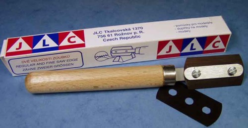

For cutting I would suggest a razor blade or tiny saw. Check JLC tools or similar:
https://www.aviationmegastore.com/img/p ... 3509_0.jpg
