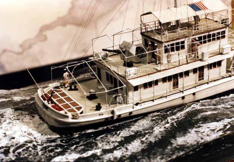

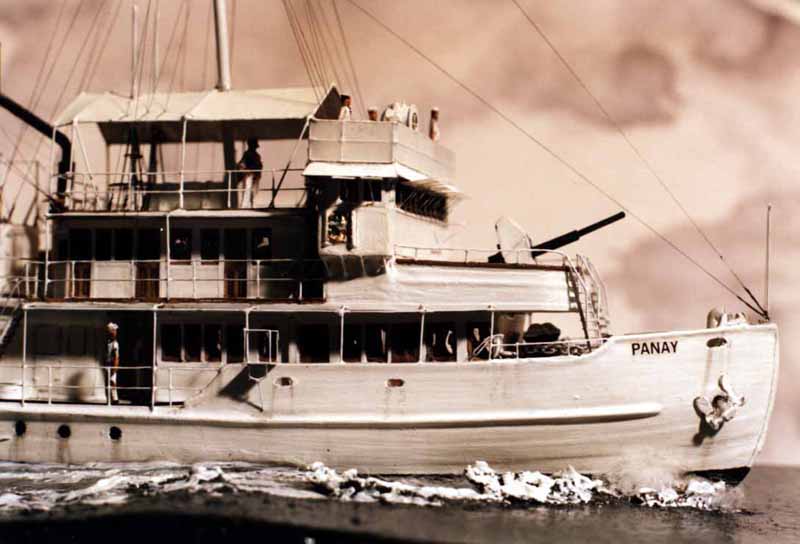

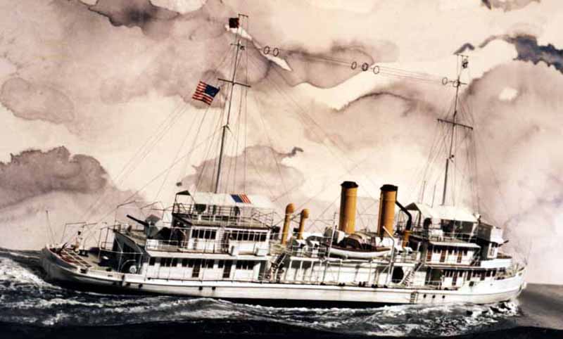

White glue--with a "RIGGER " paintbrush will span up to 1.5 inches or more
these are awnings on my 1/192 Panay ( poor old 35 mm film prints scanned!)
this image below shows the dodgers in 1/192 ( ergo = 1/200 )
the trick is to paint the railings FIRST, then apply THINNED ( 50/50 ) white glue
White glue dries completely clear-- so you paint the OUTSIDE -that way the contrasting colours
of rail and dodgers have perfect colour separation and demarcation!
Hope to help
Jim Baumann :wave_1:
