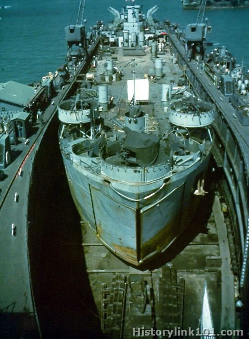

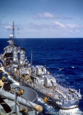

1) The plate you describe is for use if you wirsh to build a waterline model rather than full hull. You'll find that the hull iieces won't all fir together. Either the plat or the lower hull will fit to the upper hull. The only completely accurate way to place the boot top is from scale plans
2)Boot-topping painting. - The boot-topping area on oilers, cargo vessels, and similar craft with a wide variation in service drafts shall extend from a light-load waterline to 6 inches above the full load waterline.
The lower edge of the boot-topping area on other surface vessels shall be the designer's waterline and the upper edge shall be 6 inches above the full-load waterline.
On submarines, the boot-topping shall extend for the waterline at maximum beam to the intersection of the superstructure and the outer hull.
(1943 Navy painting instructions courtest http://www.shipcamouflage.com/painting_ ... 3.htm#HULL.
3) The width of the boot top would thus vary according to ship class.
4) The purpose of boot topping is protection of the hull. It is not even a simple black paint. The surface action of salt water has almost abrasive effects on painted surfaces.
Others could probably explain better
Russ
