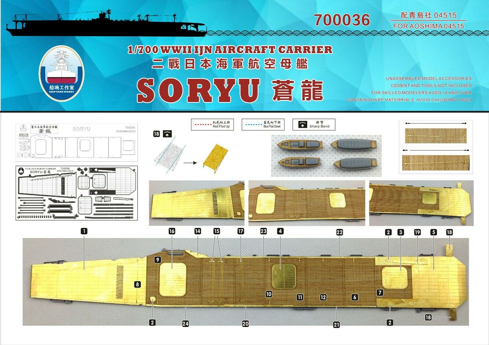

Just wanted to start off by thanking everyone who contributed to this thread - amazing wealth of information!
So I recently picked up the Aoshima 1/700 Soryu kit that is the 1941 version (No. 222), along with the Shipyardworks wooden deck/PE set. I goofed though and picked up the Flyhawk FH700208 super set which appears to be designed for the 1938 kit.
Any sense of whether there were any changes to the Soryu's hull between 1938 and 1941? I'm trying to figure out if I can use the Flyhawk set for the 1941 kit, or whether I will need to pair it with the 1938 kit. From what I can tell of the Flyhawk set, the PE seems to only modify the hull below the flight deck -- which might be work well if the only changes were to the bridge/island (not sure of the correct term there, my apologies).
I tried going through the pictures on Ryuji's thread comparing the 1938 and 1942 kits from Fujimi and Aoshima, but Photobucket has the pictures locked. For what it's worth, I saw this gentleman put together the same 1941 kit using the Flyhawk set, so hopefully I should be ok.
https://www.youtube.com/watch?v=XV5ArzTR6wY
Many thanks in advance!

There were no changes to the hull once she was commissioned. Some subtle changes to the island, yes.
Ryuji's W-I-P for Soryu: viewtopic.php?f=59&t=153083&p=590716#p590716

Dan, many thanks for the response. Good to know! I was worried I wouldn't be able to use the Flyhawk set (or would have to buy the 1938 kit). Happy new year to you, thanks again!
