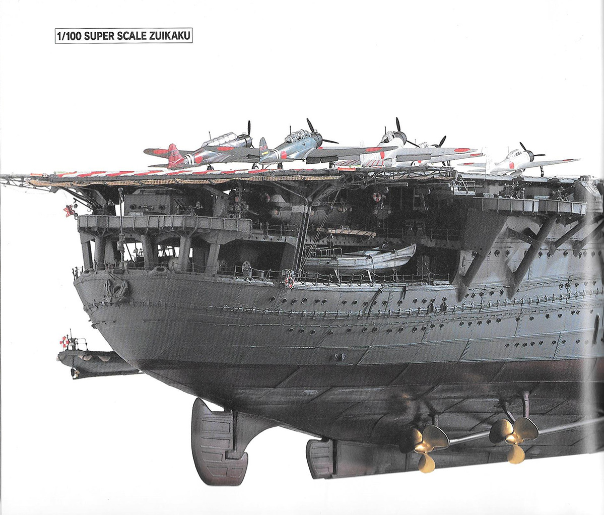

Hey there everyone, first time posting here. I'm working on a Fujimi 1/700 Shokaku with the PE upgrade set. Question about the accomomdation ladders. Are they down all the time, or were they stowed during operations? If stowed, where & how? Also are there supporting cables/pulleys for them?
Thanks!
PostPosted: Thu Jul 18, 2019 11:53 am
Posts: 8798
Quote:
I don't know if anyone came to the conclusion on which Flyhawk mast set works for Shokaku class but it is set Roman numeral III FH 350138.
Thx for that info, Gary. Much appreciated.
Quote:
Question about the accommodation ladders. Are they down all the time, or were they stowed during operations? If stowed, where & how? Also are there supporting cables/pulleys for them?
The ladders were stowed during operations on either side of the upper boat deck. I think these photos of the 1/100 Zuikaku 1942 in the Gakken dlxe volume does a good job of illustrating their usage and stowage accommodation. A stowed ladder can be seen aboard Shokaku on the previous page of this thread.
