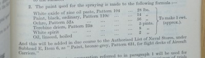

Ark Royal's flight deck would have been Bronze-Grey (you won't find it in Colourcoats - John had not heard of it)

Colourcoats is going to need that sharpish.
Edit: I intend to make some up to that formula and see what we get. All of that is easy to get hold of.
Can anyone help me with the Ochre Pattern 52a though? It's the dominant component and ochre can be anything from red to yellow which will make a huge difference. Anyone know where I can get more information of the Pattern 52a part?

Pattern 52A Ochre was described as "Ochre Yellow English" in the 1931/32 Authorised List of Naval Stores (The Rate Book).
Please note however that the formula specified for Bronze-Grey in the 1937 Rate Book listing (see below) subsequent to the 1934 AFO I posted previously is modified to Pattern 52P "Ochre Yellow". Looking at the mixes specified for other paints then, it looks as if 52P replaced 52A across the board.
Either way I think we can safely assume that it was a yellow ochre and yellow ochre is I think a standard pigment still available today from artists stores. What you get following the mix would I guess be a dirty sea green sort of colour and would perhaps explain the green on older models Sutho refers to.
Early in WW2 (AFO 2859 of 28/9/39) the RN authorised a commercial non-slip deck paint in lieu of AP631. This was available in dark grey, light grey, Home Fleet Grey, bronze-grey and black.
I think it is fair to assume that carriers carried on using bronze-grey otherwise why would the Admiralty have made it available in the new non-slip deck paint?

That's perfect - thanks Dick. I am off to order all the ingredients. I shall report back when I have made some Admiralty Bronze Grey!

When you get an idea of what it looks like can you please post photos here.
Unfortunately I have no idea what those mixes are and I have absolutely no idea about the imperial measuring system so it is like a foreign language to me reading that description.

The zinc white pigment is on backorder so there will be a short delay in making up this AP631, but as soon as it arrives (10-14 days apparently) we'll get on it.

How could I look up these forumlas on a British Standard paint chart and what chart like RAL, BS2660, BS4800 or BS5252?
I am keen to see how this colour looks

Paints used by the British Services in WW2 were not British Standard colours, although some of them can be identified in BS381C 1931. I believe that 507C was Light Battleship Grey, and 507A was Dark Battleship Grey. The names, and I presume the shades, have been retained in BS2660. However, Bronze Grey was not one of these.

Thanks. It is only the bronze grey I am interested in deciphering from the above ingredients in that photo Dick posted. I already have a decent supply of colour coats but as we have established the Bronze Grey the RN used has never been produced by colour coats. The new owners are working on it now but as I am in Australia at the present stage I have no chance of getting any more colour coats.
Paints like Dryers terebine, oil linseed boiled and white spirit to mix together to get the colour are a complete mystery to me.
It will be easy for me to go to a hobby store and get some black paint and some ochre yellow paint and mix it together and come up with a green looking colour but I am hoping to get as close as possible for this model.

I'll post up some images once I've made this AP631 stuff. The zinc white pigment was out of stock so it'll probably be after the Scottish Nationals (in the original Perth ;) ) before it gets made up. The driers and linseed oil are here already.
