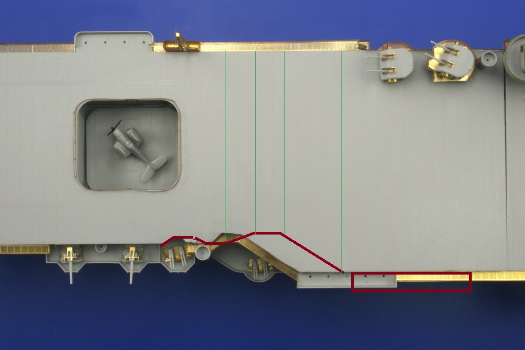

Hmm, seems Eduard got their notch for the 350scale Trumpy kit somewhat wrong. Compare Image
with http://upload.wikimedia.org/wikipedia/commons/c/cd/USS_Ticonderoga_%28CV-14%29_Hampton_Roads_overhead_30_May_1944.jpg.
Seems the 20mm portside gallery have to be more close to the deck edge elevator.

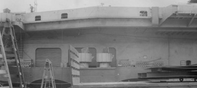

Yes - doing a correct notch wouldn't fix the kit unless they included a deck piece. Here's the photo I mentioned that shows the revised roller doors; note that the piping was laid out around the original plan for the doors. That and the watertight door to the right should help you place things somewhat.
File comment: Port side forward roller doors.

indeed, that is a very nice picture. Tells a lot and I already did my estimates. From my calculations the wide doors would be around 4.2 meters wide (13-14 ft).
Thank you alot

Hi, do you mind sharing the evidence that you have that the notch was filled in during her Pearl Harbor refit. I only ask because I've also seen claims that her (Hannah's) flight deck was lengthened but I found a picture that shows that this was not the case. I am building a 1/350 Hancock and was going to do a 1945 and did a lot of research...of course then I changed my mind and decided on a 44' with that crazy "paint job" which means... I had to undo a lot of conversion.
Now to the notch location...really??? Now I've got something to fret about!!! I guess I'm going to rework the whole fwd flight deck now that this has been pointed out :mad_1: My notch turned out really good too...good thing I got an extra deck piece.

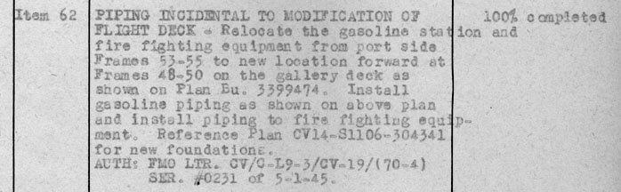

I scanned in the Arpil-May '45 Departure report last year; for those who've not heard of those before, the departure report was filed after the completion of work and listed all of the work that was done, or was not completed. That notch was a quest of sorts, and I finally found the departure report. I was in Alaska last week and was looking forward to getting back and saying "page X, April-May Departure report," however when I did get back, I can't actually find the entry that reports this. Page 17 of 43 is missing, so it's possible I lost it somehow (I'll grab it again my next trip), but I can't specifically state the page number or exact wording at this point, unfortunately. The best I can do at this point is from page 33:

Thank you Tracy,
After Stefan pointed out the notch, I started doing my own measurement and came up w/ the same positioning as his outline. I never considered that the notch was not just an extension of the flight deck angle but rather approx 22’ aft. When the notch is measured at this location on the Trumpeter kit I noticed that it would literally come all the way to the bulkhead… That’s when I took a closer look at your picture above along with this picture that I had which I never felt was “conclusive” in clarity.
However in your picture you can clearly see that the notch has in fact been “fixed”. It is very conclusive, you can see the where the 20mm gun positions were left in there after position (as compared to most other Tico’s). So I'd say when you compare the two pictures it's pretty clear that it was part of the overhaul as you stated.
This had always been a question of mine because the flight deck clearly was never lengthened as it was on Ticonderoga and the Mk 51 positions moved outboard to the catwalks. Also of interesting note is that the flight deck level 40mm Guns adjacent the 5"/38 positions were NOT lowered and should still have their cut-outs :scratch: Good lord the Hancock certainly was a unique carrier.
So I spent about two-hours carefully cutting the forward flight deck off of my Hancock and prepping for a new section. The position of the notch will now call for some real care to redo and yet be able to still use the catwalks in the Eduard kit.

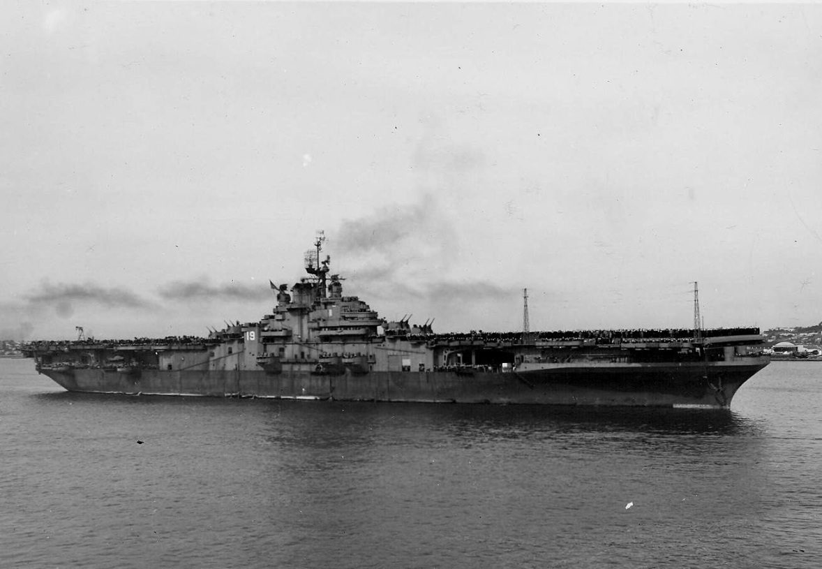

I have not seen this picture on this forum yet so I thought I'd include it too; it is Hancock probably late 1945 Operation Magic Carpet returning to Alameda CA.
-Rob <><

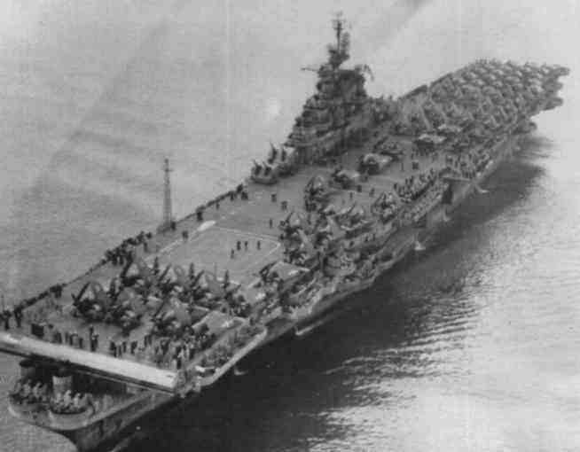

I have a post-war photo of Hancock in mothballs at PSNY. (Got it from Rick Davis) It shows the short deck and the filled-in notch area. Hanna's uniqueness continued through the initial modernizations. To the best of my knowledge, she was the only SCB-27C to retain the tie-down strips in the deck (at least, pre SCB-125), and the only -27C to put to sea with the bow twin 3" mounts in place.
