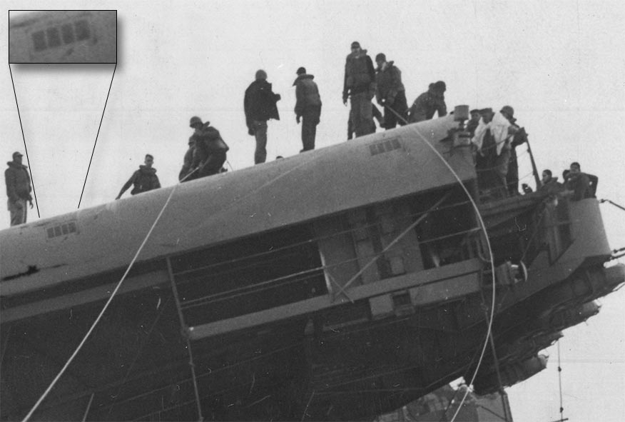

Would anyone happen to know if the landing lights on the flight deck on WW2 carriers were glass that was flush with deck or were they some type of mechanical apparatus that opened up when needed. Thanks, Jon
PostPosted: Sun Dec 06, 2020 12:10 pm
Posts: 10567
Location: EG48
There were many different lights with a variety of function and designs. I've come across drawings of early 1950s deck lights but nothing earlier and no other drawings for the Essex class.
PostPosted: Sun Dec 06, 2020 2:13 pm
Posts: 558
Thanks Traci.
I was more interested in what I believe are lights ( rectangles on the kits )on the round downs. Have been doing some flightdeck painting and not sure as to what color they were i.e. glass or metal.
PostPosted: Fri Dec 11, 2020 8:43 pm
Posts: 10567
Location: EG48
Hey John - try this. Looks like a slotted grill of some sort.
