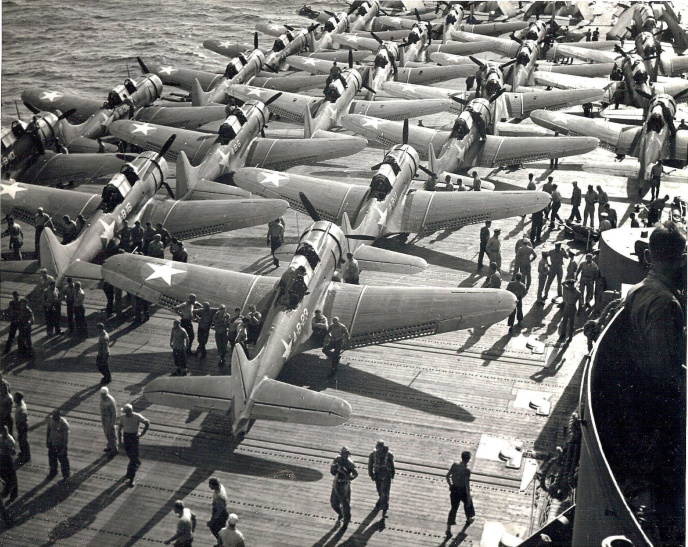

Can anyone shed some light on this photo? It's from World War Photos and the caption reads "SBD-5 of the VB-4 USS Ranger October 1942". It seems to show planes from Air Group 4, VB-4 but on an Essex Class carrier. You can just make out the rear of a twin 5 inch mount on the right. The aircraft markings appear to be from 1942 but on an Essex Class carrier? I know Air Group 4 operated on the USS Essex (CV-9) but with these markings?

Good question. However, it looks small for a 5"/38 twin mount?
PostPosted: Wed Mar 24, 2021 8:43 am
Posts: 10567
Location: EG48
It's on an Essex class carrier, the caption is wrong. I don't have the time at this point to go through war diaries to try and determine ship and date, but we're looking at the edge of a quad 40mm mount on top of the pilot house of an Essex class carrier. Flight deck is too wide for Ranger as well.

Thanks Tracy. Looking closer, there's a lot of shadow on the deck but is there a black stripe along the centreline? That would ID it as Yorktown. On Shakedown perhaps?

I would say perhaps after shakedown; an examination of the deck logs might shed some light, but I agree it's likely CV-10 Yorktown.
