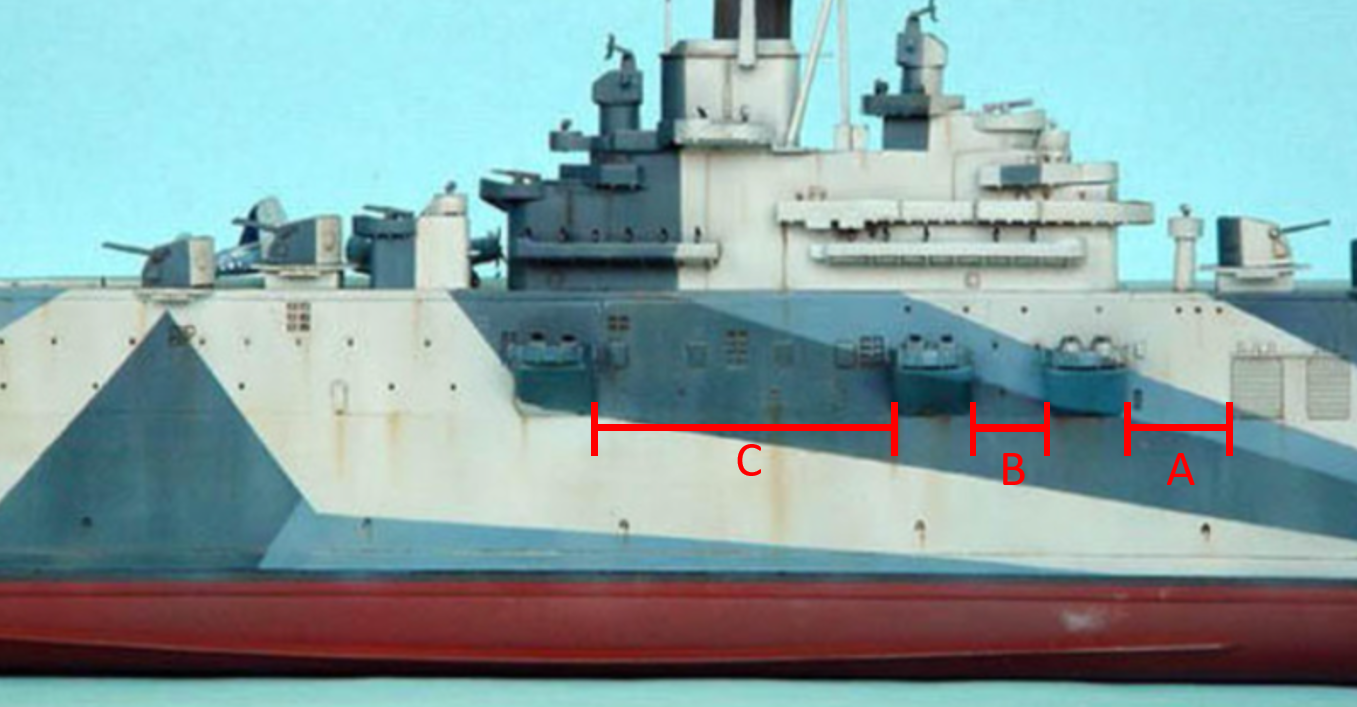

Another question, because I was originally planning on depicting this ship in her 1944 configuration without her outboard 40mm guns, I didn't drill and cut out the guide slots for the 3 outboard starboard side 40mm gun tubs underneath the island. Thus, I need measurements to make sure I put them in the correct spot. Can anyone help me with these 3 measurements illustrated below by either measuring your model or referencing drawings (and converting them to 1/350, obviously)? For measurement A I am using the edge of the hangar door as a reference point, but the others I just need the distance in between. You can use either imperial or metric, whichever is more accurate.

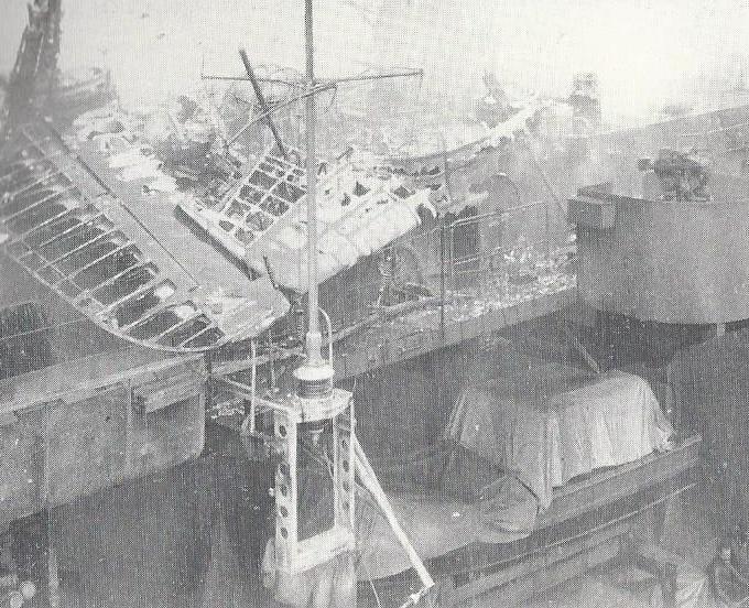

PostPosted: Mon Dec 05, 2022 7:17 pm
Posts: 4041
benjamin.marn wrote:
If Boxer had them, then I will do the whip antenna on Hancock. Do you have any drawings/info on the spacing between them? I assume the outermost two are attached where the cage antenna (is that what they're called?) were formerly attached, but I'd like to know where the two in between them should be placed. If you're able to find any info, I'd also be interested in finding out how tall they are. What you all think I should make them from, something stiff and hard to break like steel or brass wire, or something flexible like stretched sprue?
Hope this helps show a whip antenna in detail.
The photo shows how the antenna was suspended on swivels from two parallel girders extending outwards from the hull just below the catwalk. Note the very conspicuous counterweight.
This photo is of USS Bunker Hill CV-17 taken shortly after she was struck by two kamikazes in quick succession, setting the vessel on fire. Notice the burned out TBF Avenger on deck.
