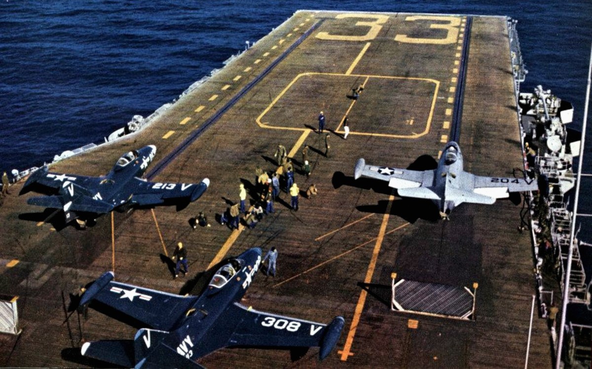

As a rule of thumb, these planks are usually 20ft (6.1m) long. In European ships the common length is 6m, so almost the same. This means you need a little over two planks to cover the width of the deck.Tracy White wrote:Somewhere I've got pictures of one of the ships having her flight deck re-planked and that might help with an estimate, but I've never seen documentation that spoke to the length of the plank.
Just like the usual planking of ship's decks lengthwise, the butts of the planks wil be laid alternating. These butt ends are hardly visible as there will be no caulking used in those seams.
Using much longer plangs covering the width of the deck in one go would make the planks unnecessarily expensive.

Maarten Sch�nfeld wrote:As a rule of thumb, these planks are usually 20ft (6.1m) long. In European ships the common length is 6m, so almost the same. This means you need a little over two planks to cover the width of the deck.

I underestimated the width of the Essex deck, I did. But the figure of 20ft for a single plank is still valid. So you need five or six planks athwartships. Plans of much more length are 1) unnecessarily expensive and 2) very clumsy to handle.
Still, you can hardly observe the butt ends. This has been discussed in several places on this forum, those butt ends are set without caulking. Only the long grooves between the planks are caulked. Also, because all the rubber (and oil and dirt) by the air operations made those decks soon very grimey, and made them loose their official blue paint as well.
I'm working now on a Korea time Essex class, you can hardly see any blue paint left on the deck. Only the yellow markings are apparently refreshed, but nothing else.
