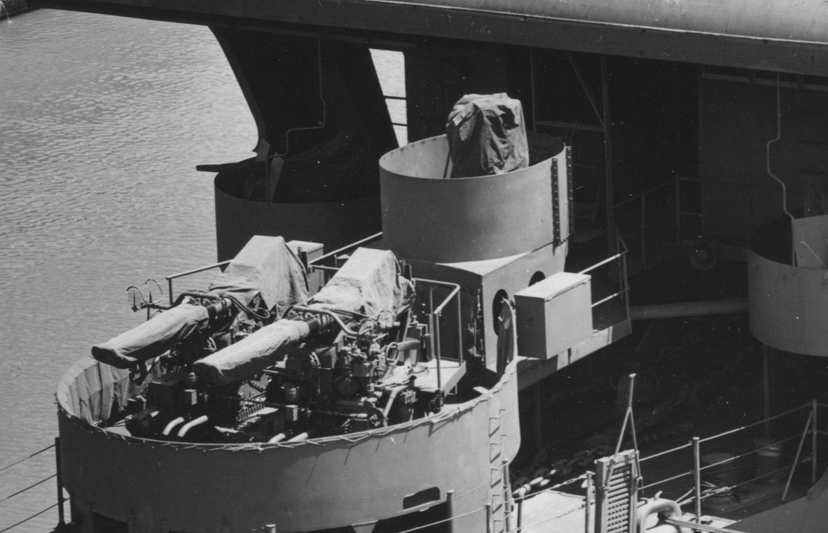

PostPosted: Tue Aug 04, 2015 1:56 pm
Joined: Tue Aug 04, 2015 1:25 pm
Posts: 4
Hi guys!
I'm new here ,active, few Years I just lurk here :-)
Im 48, live in Croatia, Europe, and recently I've start CVL-22 in 1:72, in dazzle camouflage, measure 33/3d
Thanks for all pics and answers here, this topic is already saved on my hard disc :-)
So, I've been looking everywhere, but can't find any picture from gun director for bow quad and structure below it( red circle)
I ca't figure out as follows :( see picture:)
1.what is this structure below gun director tube, ( purpose, details? )- could it be ammo storage?
2.what are those holes and what's inside? ( yellow circle)
3. From where is crew acces to gun director -ladder outside, inside, doors, hatch??
and beside this, the blue stripped and colored parts - decks - I think it's deck blue, right??
Any help will be very aprreciated.
If isnt allowed to post pictures here of models, let me know so I will remove them
At the bottom is my Belleau Wood few months ago, just coverd with primer, upside down- those large hole is to acomodate rear lift mechanism)
PS sorry for my bad english, I've learn German in school :-)
Best regards
TIA
Mario
PostPosted: Tue Aug 04, 2015 5:18 pm
Posts: 10579
Location: EG48
Hi Mario. That is a big project!
The area below the director tube was just a structure built up to elevate it so that the director could see over the guns. There was no ammo stored there. There are two ammo boxes that are mounted on the outside of the railings instead (see photo below).
The holes are to allow access to below the director (to access bolts for removal, etc.) and possibly to make the structure lighter. I have seen holes for such purpose on other ships, but have not seen any notes in the plans that state why they were there.
A Ladder on the back of the tub
