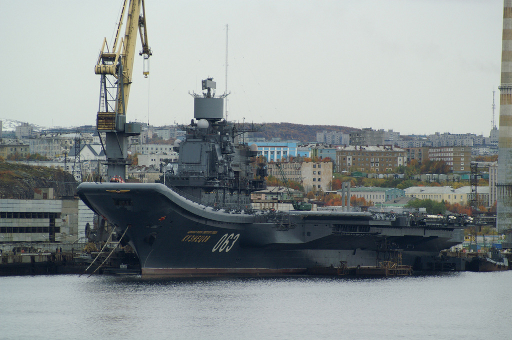

Can someone tell me what color the hull is in this picture:
I'd really like to match this color for my build. Thanks in advance.

I have many images of the Kuznetsov and all have what looks like a different shade of grey. My model will end up with a simple grey colour on the hull simply because when it will be shown on either display under indoor light or on the water outside, the light source will change the grey to suite. I have built warships in past and under different light conditions outdoors the grey colour seamed to me to change. Overcast would make the grey darker and sunny would make it lighter.. go figure this one and then try to match your grey.... :roll:
Then on top of this in my case I will have wear and tear, rust etc. :faint:
