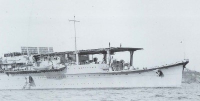

I was a little discouraged by the flight deck situation, but I'm back at it. I'll figure something out for the flight deck.
Going through all the PE I now have and figuring it out. I have two questions:
1) "sea stairs" - I'm not sure what the right term is for these, but they are the stairs that comes down the side of the ship with a small ramp at sea level for someone boarding via a boat. Anyway, what happens to them when the ship is underway? Are they completely taken in, or just raised up to the level of the deck where the top of the stairs are, or what?
2) "flight deck wings" - again, not sure what the right term is for these, but they are the wing like things sticking out to each side at the back of the flight deck. I have two options on finishing them - there are two solid pieces of PE that sit on top of the assembly, one deeper than the other, and it says optional. I have no idea what the difference between the two are. I'd like any guidance about those.

The "Sea Stairs" can be either a rope and wood affair that can be rolled up and stored on deck or in a nearby locker or it will be metal and/or wood and steel device that is hinged at the upper (deck) end. The steel version may be raised to deck level and secured if transiting short distances in calm seas, otherwise it will be raised aboard and stored somewhere out of the way, usually on the main deck area.

Those ladders are known as accommodation ladders, and were made primarily of wood in the IJN. They were collapsible, in that the stanchions and chain rails folded down and inward. In the Shohos, there were two sets forward and aft. The forward set was stored on the walkways above, the aft set stored on the stern boat deck.
Those landing light arrays or outriggers carried landing lights on the trailing edge to help guide pilots into the landing path. Which PE set?

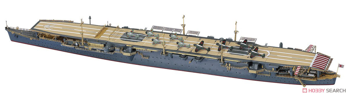

Dan, it's the Hasegawa hyper detail set. Looking at the kit there are actually three decals of different sizes with the red and white strips. I didn't go figure out whether there are three PE sizes yet, the instructions say there are two.

Apparently, the leading edge/portion of that array has a solid surface, and one set of strips goes on top.
I'm guessing that one width applies to the PE version; the other to the kit plastic version. (image courtesy of Hobbysearch Japan).
