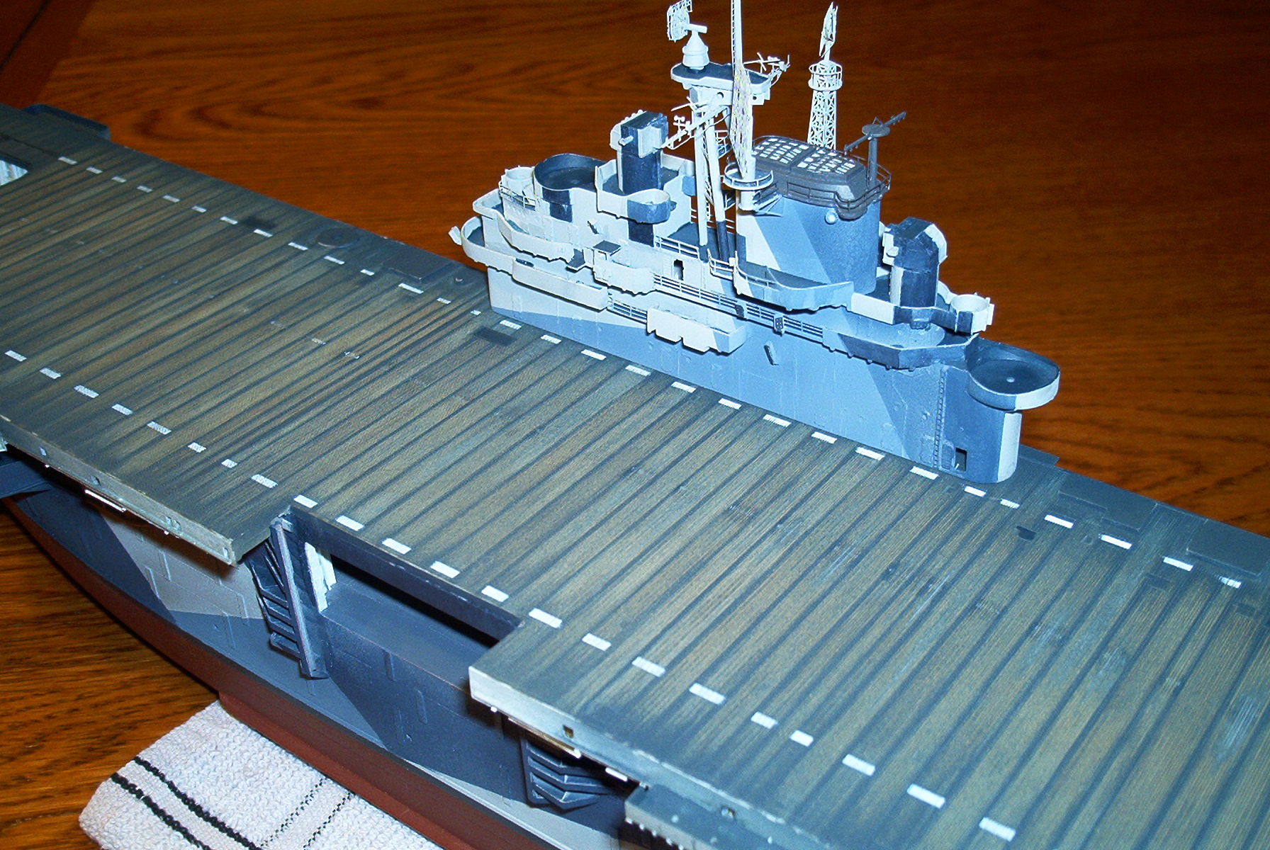

Tracy White wrote:
Check out the photos at the bottom of the damage report for Franklin CV-13's Kamikaze hit. Specifically photos 4526-44 and 4528-44.
Tracy's photos beautifully show that the kit's elevator track parts are too simplified. That's why I replaced them entirely. Many modelers use the kit parts and their models look fine that way. I think the real tracks are very interesting structures and decided to try to capture their look better than Trumpy did.

File comment: You can see the scratch-built elevator track detail in this photo of my as yet
incomplete Yorktown.
I see that the Trumpy's elevator tracks are simplified, but I want to know that the outlines of the individual platforms(?) are correct or not? If I want to improve it (or to scratchbuild a new one), I have to know the shape of this platforms.
I know that the edge of these platforms are not perpendicular to the hull, there is a cutout and - if I know well - even a vertical ladder is there just behind the track.

I think it's best to study photos to get the shape right. I haven't found any drawings that show the supports well enough to model them.

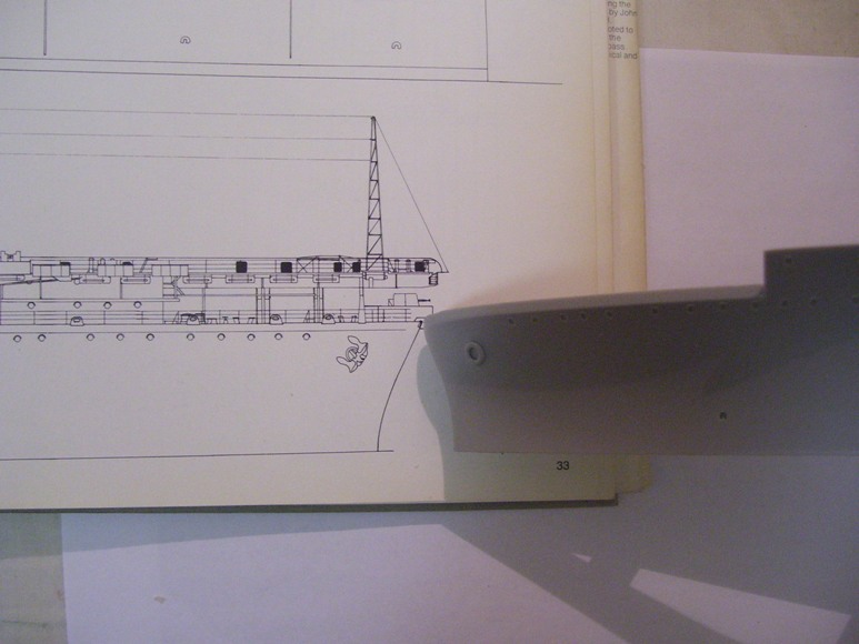

I think there is a very large inaccuracy at the 1/350 Trumpy Essex not mentioned yet nor here, neither in the reviews. I have compared the AOTS drawing with the Trumpy hull, and I have found that the height of the hull is the same on the model (1/350 scale) and on the 1/300 scale drawing! It means that the Trumpy Essex is too tall. :frown_2:
It wouldn't be the first time Trumpeter dorked up an aircraft carrier hull. Trumpy's 1/350 USS Hornet CV-8 hull is really, really, noticeably inaccurately shaped, much worse than their Essex kits. The real Yorktown CV-5 class had very graceful hulls. Trumpy's CV-8 kit hull has been referred to as a "supertanker hull" and rightly so. The perplexing thing is that Revell got the hull shape right on their 1/540 kit decades ago. Trumpy could have simply pantographed that hull and got a better result.
Not necessarily. Note that the waterline depiocted on the AOTS drawing might not be the same as where the upper-to-lower hull split occurs on the kit. As a 'for instance', the AOTS drawing might show the ship at full load (i.e., at the top extreme of the boot topping), while the kit's upper half might include some boot-topping for aesthetic or other reasons.
Consider too that the full and light load lines (i.e., the extremes of the boot topping) can change over the course of the ship's life as shipalts add or remove weight.
It's OK, but in this case the height of the armor belt above the waterline and the position of the recessed mooring line choks should be different, and IIRC these are the same on the model as on the drawing. The distance between the hangar deck and the flight deck is about the same, too.

That wouldn't be the first Essex kit that Trumpeter had the waterline wrong on... their Arizona kit's way off, but that may be as much from how they had to break it apart for molding as anything.
