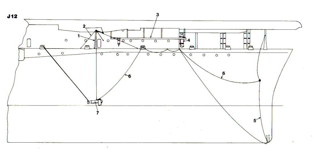

Questions, questions, questions...
My new question: how works the paravane or more precisely the paravane track?
Looking the photos and drawings I don't understand, how can the paravane moved to the side? The track goes under the "boxy structure" and the paravane stoved vertically. In this postion the paravane can not be moved under the edge of the "boxy structure" because of its length. It's seems to me that the paravane is between the bulkhead and the track.
I have found only one possible solution: the paravane have to rotate into a horizontal position and so can be moved under the edge. There is a pulley on the drawing, maybe it can be use for this purpose. What do you think?
I will continue it in the next post because I can attach only three photos...
File comment: Drawing from the AOTS showing the paravane with tail upwards.

Paravane, part two...
At first some quotes...
From the page 39:
(There is a very good photo of Hancock by Tracy showing the paravane track.)

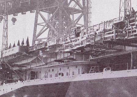

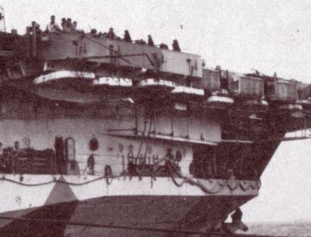

I think the rail don't went from one side to the other. There are some objects that block the way, e.g. the light labyrinths and there is an inclined ladder too, see the AOTS drawing A7/2. It can be seen on the attached photo of Essex how the track ends.
It is interesting that at some ships this paravane track is positioned higher and goes around the "boxy structure" instead of under it!
About the sources: the mentioned Warship International No. 4 / 1999 is a special edition about the Essex class carriers.
File comment: Part of a photo from the Warship International: Essex on April 15, 1944, official USN photograph 19-N-79141. Note the end of the paravane track and the paravane is with tail downwards. The inclined ladder can be seen as well.
File comment: Part of the photo of Antietam from the Warships International, official USN photo 19-N-89571. The paravane track is around the "boxy structure".
The paravane track was used to move the very heavy paravane from its stowed position to it's launch position under the bulkhead davit. After use, it was then used to move the paravane back to its stowed position.

Steve Larsen wrote:
It was self-evident for me :big_grin: but I don't know how can the paravane be moved along this track? How much does the paravane weigh?
Remember that the paravane itself is merely a large, winged, weight that pulls a cable away from the hull using the ship's bow energy wave to swing the cable clear of the ship. It is the cable that clears mines, not the paravane. Several hundred feet of cable is very heavy therefore the paravane must be heavy enough to act on the cable. Also, the paravane has to remain submerged in order for it to "swim" properly.
There are a few paravanes at the USS North Carolina Museum, two on deck and one off ship. I remember trying to lift the one off ship. It was merely resting on a cradle under its own weight. I am certain it would take several men to move one even with the aid of mechanical help.
I can't tell you exactly how heavy one is. The best answer I can give you is that a paravane is heavy enough to require an overhead steel track to safely move it around a carrier's forecastle.
There is a steel harness welded to the body with attachment rings. I am certain these rings were used to attach tackle to the paravane for lifting and towing purposes.
There are similar tracks in the hangar deck on the overhead and below decks near the machinery shops and magazines, at least on the modernized Yorktown as she now appears on Charleston, used to lift heavy equipment, bombs, torpedoes, aircraft engines, etc. They are basically large, steel I-beams. On these tracks is a dolly with four steel wheels that run along the I-beam fillet. IIRC, the dolly had one or two lifting points to attach tackle.
I wouldn't be surprised to learn that men lost fingers moving that dolly along a track on a ship that pitched and rolled.
