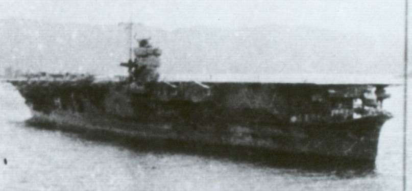

The handful of known wartime photos of Soryu are too blurry to make out a detail such as a degaussing cable. (Those of Soryu at Staring Bay 1942 might be the clearest but, still indeterminate.) Still, it would be hard to imagine that she did not get one.

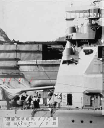

It may be that there are differences in the hoods between intake and exhaust. In examining Hiryu, for instance, I believe I can see two different setups. If we focus on her port side, on the two hull protrusions to either side of her bridge, we can see an obvious hood covering on the right side - first photo below.
However, on the leftmost one, what looks to be just some sort of grab rail or something at the top of the protrusion in the first phto appears to be a much narrower sort of hood aperture when viewed in the second photo below (ignore the line of red arrows - they refer to something else from another discussion).

Thanks, Dan. The right intake on the first photo definitely has a hood and Aoshima’s 1/700 Hiryu model kit should be corrected at this point. As for the left bulge – I am not sure. This detail (on the second photo) may be interpreted as a narrow footpath, and what seems like a left edge of the “hood” may be a continuation of the long shadow of something hanging from the edge of the flight deck. There still is a questionable dark blot above that bulge on both photos…
Anyway, let’s wait for the announced Fujimi 1/700 Hiryu; as I can conclude from the photo on HobbySearch (http://www.1999.co.jp/eng/image/10160875a/20/1) there is a hood over the intake right to the bridge.
Aoshima 1/700 Soryu seems to have all bulges hooded on the portside.

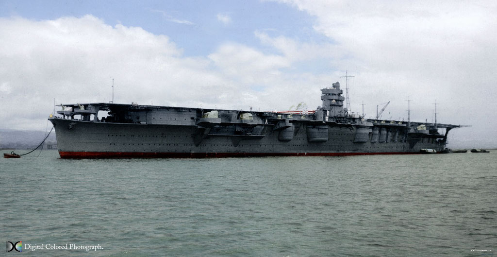

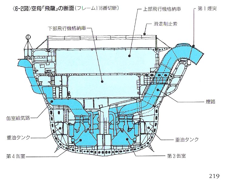

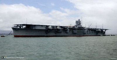

First, an illustration for the Gran Prix Shuppan volume on IJN CVs which happens to correspond to the very area on Hiryu that we are discussing, at frame 116. This aligns with #1 funnel on the starboard side, and the the bulge ahead of her island on the port side.
Second is a colorized photo of Hiryu's port side that shows all these areas in better relief. Many of the hoods are shallower than the one aft her bridge.

PostPosted: Fri Nov 11, 2011 7:12 am

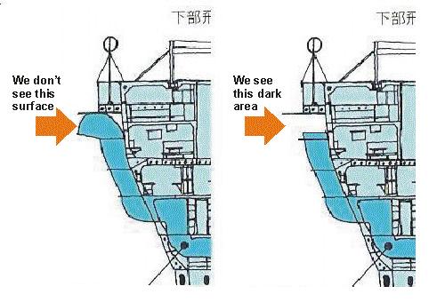

Well, as far as I can understand Japanese, the label of that left blue funnel on GPS picture means “ventilating shaft”, isn’t it?

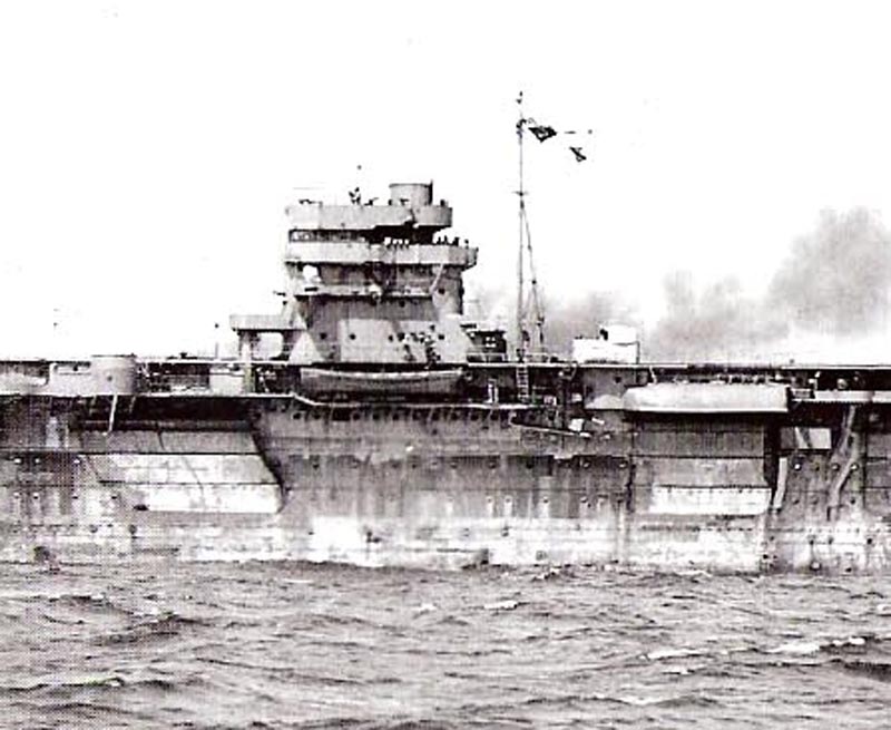

Just kidding – I saw this picture translated into Russian. Seriously, I think there is a contradiction between what we see (on the photo) and what we believe in (the GPS picture). Have a look on what I mean; the hood on GPS picture is too broad to conform to Hiryu photo. I agree, there still is a possibility the intake was lower, and the hood was shallower – and narrower.
PostPosted: Fri Nov 11, 2011 4:12 pm
Posts: 8561
Well, I think if the inlet were truly open, it would covered with a grill, as with the Shokakus. I'm certain there is a hood; it's just that the overhang/lip is smaller than what's illustrated.

My assertion about these engine intakes may be only partially correct. In reading thru the GPS translation, it seems that some of these hull projections were engine room ventilator shafts. However, regardless of intake or compartment exhaust, it would mean they would have to vent into the hangar deck, thru the sidewall. (I can't confirm this). Which I find problematic because of the volume of air that would need to be displaced. How well could they possibly vent into the hangar decks if the lifts are closed/level with the flight decks?
Which is why some sort of external vent makes more sense.
