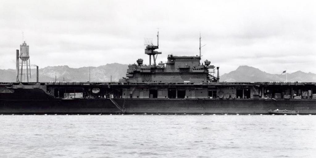

Pic new to me. Courtesy of R. Bean from another site.
CV6 May 1942 prior to Midway. (I mislabeled the pic when I saved it.)

Posts: 476
Location: Brooklyn NY USA
It is a May 26, 1942 photo, one of several shot of the ship from several angles that day. This is actually a crop of a well known full length photo.
