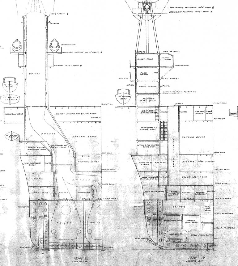

The flight deck was stained with Norfolk 250N or was it 21/251?
Also these ships have an armor belt. Should this be visible in 1/700 and 1/200?
Thomas E. Johnson
http://www.youtube.com/user/ThomasEJohnson
PostPosted: Sun Nov 04, 2018 10:59 pm
Posts: 9835
Location: EG48
You haven't said when you're doing yours, but Flight Deck Stain 21 didn't come about until 1943.
Armor belt:
PostPosted: Mon Nov 05, 2018 2:05 am
Posts: 1154
Armor belt:
I’m doing mine for whatever time frame the Trumpeter kit portrays.
I’ll have to represent the armor belt on the 1/200 model with some Evergreen stock.
