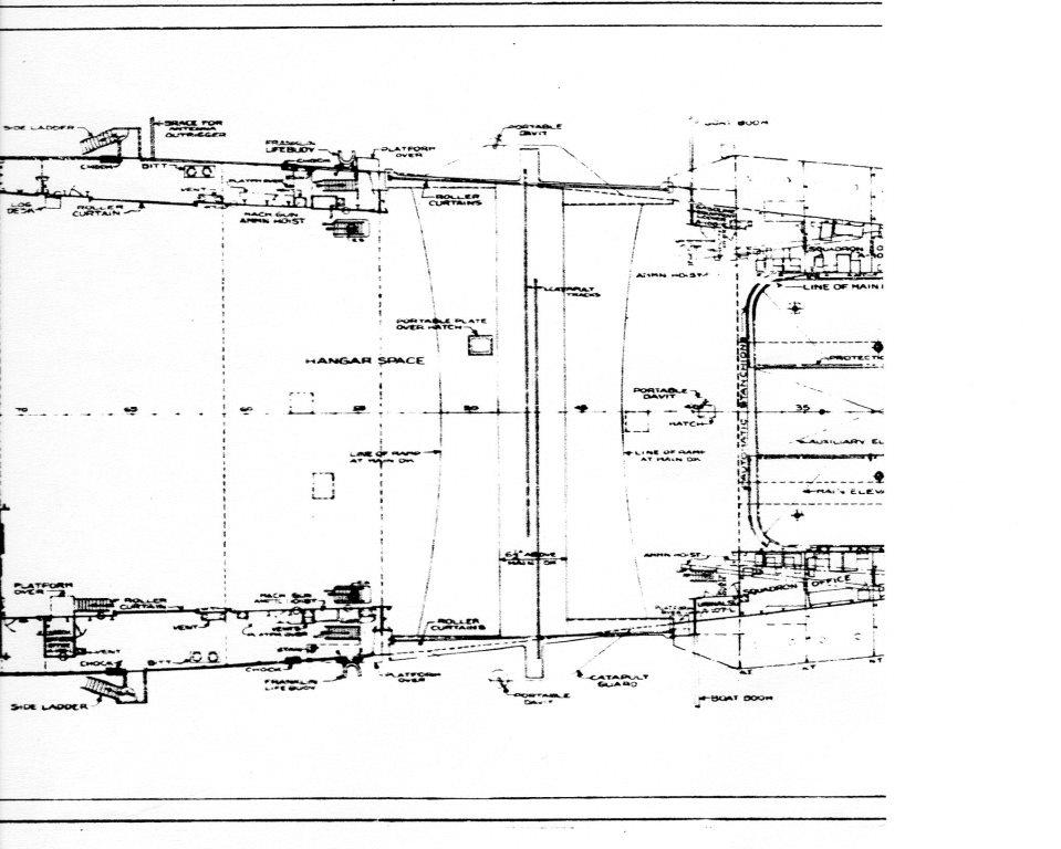

Looking through the pictures I have of HORNET, I was counting the number of groupings (three-raft clusters if you will) and came up with 18 - seven to port, eleven to starboard. I noticed that while there is a rack with a three-raft cluster on the focs'l deck outboard of the catapult gear enclosure, I have found no pictures that show the same rack on the port side. So my question is: is the total number of clusters eighteen and there is no rack to port on the focs'l deck?
Also, Dick J - you commented on another thread the WASP (CV-7) had two hangar deck cats while the YORKTOWNs and ESSEXs with those cats had only one. Plans I have show two tracks on (at least) HORNET which might be powered by a single ram, but two tracks nonetheless that each start and end at a different point compared to the other parallel track (i.e. it is not a pair of tracks of identical length that start and end at the same points - the tracks are staggered). Did WASP have a second track (and ram?) aft in the large roll-up doors near the aft 5" gun galleries? Curious.
I am not sure exactly what your plans are showing. As for my previous statement, I never mentioned how many hangar cats were on any of the Yorktown's, although there should be only one on each. As I recall, I stated that 6 of the first 8 Essex's had them and that Wasp had 2 of them. (Essex and Lexington commissioned without hangar cats - they weren't ready yet. Franklin had hers removed prior to deploying, leaving Yorktown, Intrepid, Hornet, Bunker Hill and Wasp (CV-18) as the only Essex's to carry them into combat.) Wasp (CV-7) had one hangar cat in the large opening just aft of the forward 5" gun galleries and the other in the large opening just forward of the after 5" guns.

Nope, you didn't make any comment on the number of hangar deck cats on the YORKTOWNs or ESSEXs, but used the term 'cat' which I took to mean a single unit. I kinda assumed that the cat worked in either direction, to port or to starboard, with a single double-acting ram. The tracks shown on the MD Silver plans for HORNET are parallel to each other, maybe six inches apart, but they are do not start and end at the same location on each side. Here's part of the plan:
With the tail of the plane on the, say, port sponson, the end of the starboard-facing track would be just under the plane's nose so it wouldn't make sense to have a longer track. Vice versa for a launch to port. There could be two separate rams, just not sure, but I figured it was just one. I know none of the cat would be below the main deck since that was the armor deck and one wouldn't want any more penetrations than absolutely necessary.
I hadn't realized WASP had two separate cats and was wondering if it was the same or different when compared to the paired tracks of the HORNET (and presumably all YORKTOWNs and all ESSEXs, though I don't have plans other than for HORNET at the current time) shown in the plans above.

John here's plans of CV-5 and CV-7 from 1940 and 1942 respectively.
http://www.hnsa.org/doc/plans/cv5.pdf
http://www.hnsa.org/doc/plans/cv7.pdf
Both show the same double tracks as your plans of CV-8. Anyone with CV-9 class plans or the AOTS volume on Intrepid?

Per AOTS Intrepid page 45, CV-9 class with hangar deck cats was conceptually identical to the CV-5 class hangar deck cats. Two parallel tracks, 90+% overlap, and scaling up the AOTS drawing approximately 16" center line separation.

Thanks Jim! Looks like it settled then eh John? :thumbs_up_1:

Yup, looks as if all three classes had the same arrangement of the hangar deck cats - paired tracks through the large roll-up doors just aft of the forward 5" gun decks.
Thanks for posting the plans - as always, plans are the curse for those trying to make a ship model quick and easy to build. Where is Nelson's 'blind eye' when we need it?
I've convinced myself that the life raft stack on the starboard focs'l deck was not duplicated to port for whatever opaque reason as may have existed when HORNET was completed and upgraded / refit for her transfer to PAC. There is a small 'Z' shaped platform attached to the port catapult equipment enclosure that might have interfered with locating the raft stack there. The platform to starboard is just a straight one out from the side of the catapult equipment enclosure.

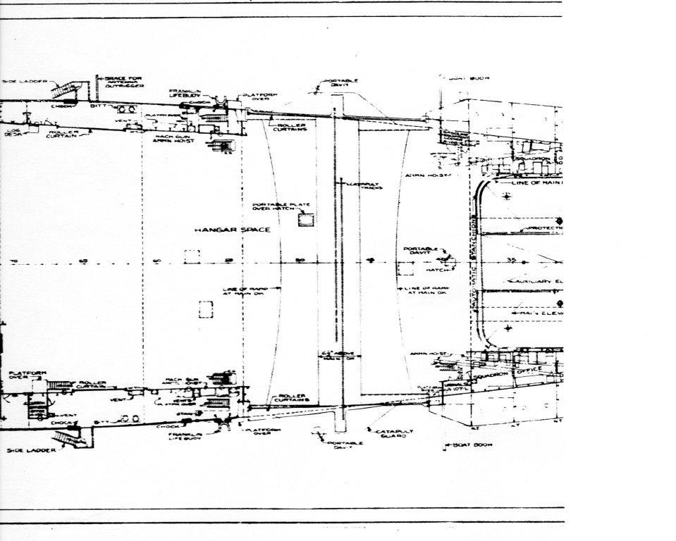

John W. wrote:
Dick -
Thanks for the response. Any comments on the focs'l life raft rack to port - installed or not?
Hi John, One hangar catapult on Hornet and her sisters. The two slots are just for shuttle orientation as this cat worked either direction. It was set up for the direction of launch accordingly, and used the shuttle slot meant for the proper direction of launch. The two tracks are for port to starboard launch and for starboard to port launch direction. It is the same unit, though. As for Wasp CV-7 , she DID have two actual hangar cats, one forward like the Yorktowns and one aft. The aft one shows in early war photos, where the folded up sponson is visible. It was removed early on, and does not show in shots taken after the yard period when she returned from the UK.
On the port side fo'c's'le, I checked many photos and found the life raft nest was only mounted on the starboard side. The series of shots taken 2/28/42 at Norfolk show the starboard nest and none on the port side. I also have a nice crisp shot of the Northampton tow, and you can see the starboard side nest in place and none to port.

Thanks for clarifying both issues. I figured there could be just one ram for the paired tracks, so thanks for the confirmation. It would be interesting to know why the aft hangar cat was added to WASP since it is not shown in the plans. I know the USN was trying to figure out lots of different angles for a problem we now take for granted that we've solved, so I guess they figured it was worth experimenting with a second unit aft.
Thanks also for confirming only the starboard raft rack on the focs'l. As I opined above, it seems as though the small Z-shaped platform to port, off the catapult gear enclosure, would have interfered with placing a rack there. There's also a bollard to contend with on the deck, so my fiction is that there just wasn't room.
