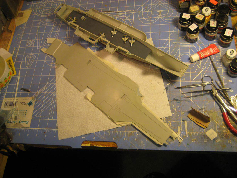

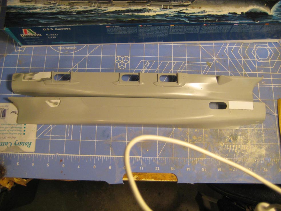

Posts: 657
Location: Michigan
If i had it to do again Id use the Italeri 1/720 Nimitz...oh well used the America kit... I added a simple hanger deck, dropped two elevators, added two JBD in the raised position,lenghted the deck so round down is over stern,added the correct angle at end of angle deck

JasonW wrote:
Okay, so I've read through this thread and now I'm a little more "enlightened" at any rate about the JFK. Now, the questions.
In order to build a 1/700 (or close anyhow) JFK, I need to start with the Italeri Nimitz and America and use the hull and flight deck of the Nimitz and sponsons of the America with a vastly modified America island?
Bill, how did you scratch the island? Did you have plans to work from?
I keep hoping that some manufacturer will release a JFK, but after 25 years I guess it's time to face reality and the realization that if I want a JFK I'll have to bash it out of other kits.
Jason I used the Italeri America Hull and grafted into its flight deck the angle off the Nimitz flight deck see that photo of the deck in progress...I also added a slice aft as the deck didnt fit over the stern as it should.. I scratched the Island from picture sourse only.. I rebuild it 3 times before I got what I though was a close aproxamation of her early Island before refit.. America kit had all the sponsons removed as I did Kennedy as built..see the photos were plastic.. I used the Nimitz sea sparrow launchers and Nimitz bridge windows.. sorry I didnt answer before now..didnt see your post till today..
