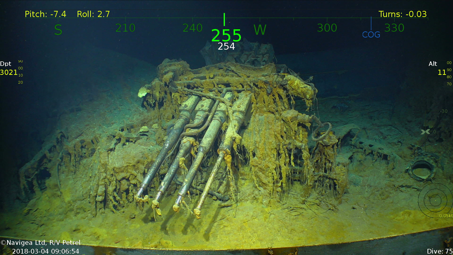

So here's a photo of one of her 1.1", in an position that I (and others on Reddit) could not identify - any takers? Not sure where the original poster found this photo, as it's not included in the video.

It's here...
https://www.paulallen.com/uss-lexington-wreck-located-rv-petrel/
There's a slide show at the bottom of the page. Only the one 1.1 mount pic, but they have found several Devastators in what looks like really good shape...raising one wouldn't disturb remains and would be a huge historical find. I don't think there are any surviving examples on display anywhere, are there?

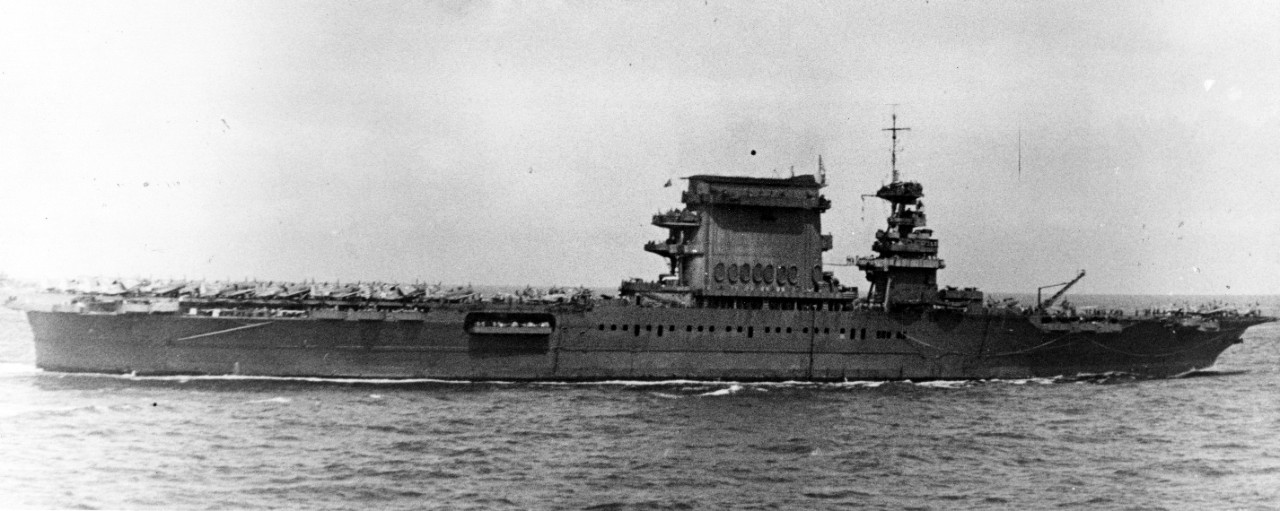

Saw the sight survey map with ship and debris field. Unfortunately the ship is in 3 pieces. Section of the stern and bow not to far apart and the midships section of the ship 4 miles away from bow and stern, Also the bridge has been blow n off the ship and rest in between bow and stern and middle sections of the ship.
One thing I noticed when the video showed the stern that the paint on the aft 1.1 sponson and aft round down was the same when Mr Ballard found the Yorktown. Yorktown as Hornet was painted in navy blue bellow Hangar deck and ocean grey with 1942 colors similar to sky blue above the hangar deck. It seems Lexington might have kept her navy blue/ocean grey paint after all. She is not overall navy blue in the Coral Sea. Her color after 70 years is the same as Yorktowns, They were only sunk a month apart. I have the Lexington book that shows her in Pearl removing her 8 inch guns and she has the I believe they called it Measure 12 Cammo. Hornets was modified with waves as was Wasp. I think she did not get repainted because in the coral sea pictures you can see were the ocean waves have altered the pain near the water line. My thoughts. Further video and study required I am sure.

To me the best source for this topic is the WP 33 pg 50/51 photo that is considered the last best photo of the Lex before smoke obscured so much of the detail that we endlessly debate here. The only real problem is that it's really grainy and hard to decipher detail That said, to me, it appears the whole ship seems to be the same color. It could be argued either way but that's how I see it. And the detail of the front of the flag bridge is also very grainy and it's impossible to say one way or the other if it has a passage at the front like the Sara or not. Just more fuel for the fire.

Wiper's book shows her being repainted at Pearl in April, when her 8 inch gun mounts were removed. This photo seems to her in one overall color:
You can download a hi-res version here

Since the videos and other pics are of the stern I would hazard a guess at this being one that replaced the 3" gun on the rear platform.
