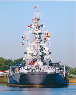

Does anybody know, please, what do mean these signal flags at North Carolina?
https://www.battleshipnc.com/wp-content/uploads/2018/01/Stern-Shot.jpg
I tried to decode it, IMHO I found 1945, 1995 and BB55. But the rest?
Thank you in advance.

The third from the left is the ships radio call sign November, India, Bravo, Kilo.

Reading vertically from outboard to inboard on the starboard yardarm:
1. ILMC (All flags)
2. BB55 (This is two Flag Bravos followed by two No 5 pennants)
3. NIBK (All flags)
Reading vertically from outboard to inboard on the port yardarm
1. VJDAY (All flags)
2. 1945 (All numeral pennants)
3. 1995 (All numeral pennants)
The significance appears to be predominantly American; which I am not, however, I think that this answers your question.

Thank you both. :thumbs_up_1:
