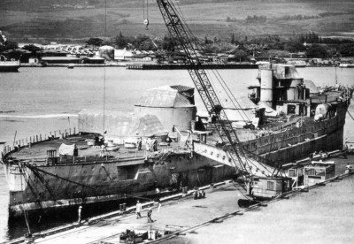

Interesting photo - one I've never seen before - of Oklahoma, post salvage. I found it on Facebook, and, after saving, forgot to make note of which page I saw it on :doh_1: I believe it was one of the battleship-related pages, I just forget which one.

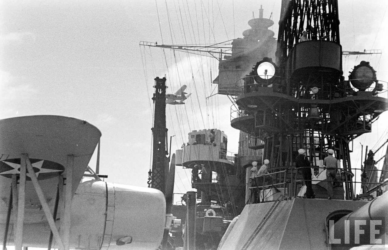

There is a quartet of "cages" underneath the SL platform on Oklahoma.
Two questions:
1) What are they for?
2) Anyone have any better pictures of how they are attached to the underside of the SL platform?
I looked at all the pics I had and the BoGP, but I haven't quite figured out the placement. I may just leave them off, as I'll have to cut the PE to fit the support struts on the 3D printed SL platform to get them to fit.

They are associated with the Searchlights. I will look if I have any clearer OK/NV images but here are a couple of Pennsylvania’s.

PostPosted: Mon Sep 25, 2023 11:54 am
Posts: 8798
Yes, but what were the cages/baskets used for?
I'm guessing they were installed aboard all the standard BBs.

I am trying to find my source, but I have seen these referenced somewhere as "Searchlight Control Platforms". They do seem to be empty semi enclosed boxes that were meant for standing in, but there seems to be nothing in there that looks like controls or other equipment. Wild guess, perhaps they were some sort of lookout blind? With the light blocked above, less chance of observer having their vision impaired by the light?
A couple more shots of Nevada's, not very clear

there is a panel on at least 2 of those cages
That very well may be, almost any clear image shows nothing there earlier than 42, so I did not take them at face value. But it is possible due to angles and shadow, that the controls were moved around and were closer to the inboard. This image of Maryland I believe shows a panel closer to the mast which could have been Searchlight controls.

Better view of MD's, circa 1939. Definitely some panels mounted on the cage sides.
PostPosted: Mon Sep 25, 2023 2:47 pm
Posts: 8798
The axle of each searchlight extends down thru the platform. And, it has a handle to each side at its bottom, almost like a periscope. Unless that is a bar running thru the post and attached to the sides of the cage. As if an anchoring point.

Thanks guys. As Matt said, maybe it's a primary or even secondary control station? I have to imagine those things got HOT and BRIGHT when in use.
Matt - those pictures help. Looks like the bottoms of the platforms are perforated, not solid, and are not square (as the kit PE is) or even rectangular, as the Big 5 one's are. They are more pie shaped.
I think I'm going to leave them off.
