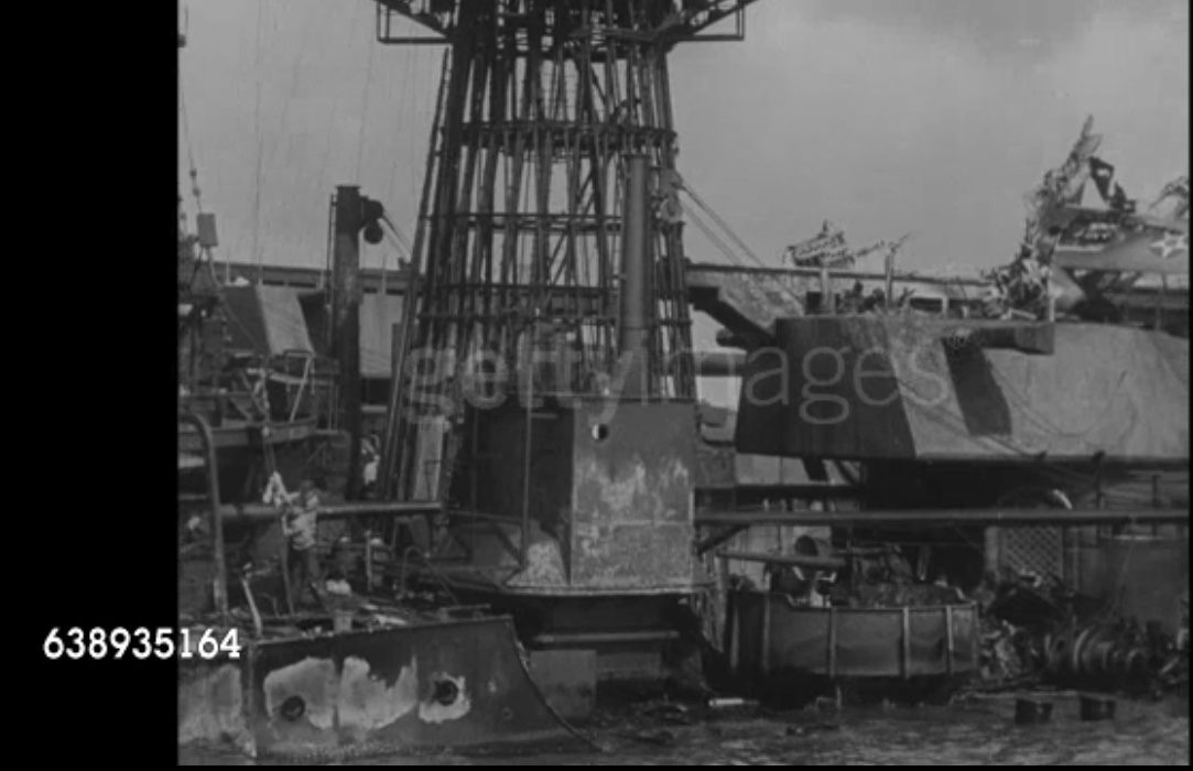

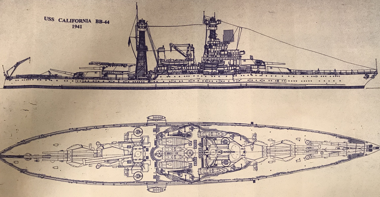

I stumbled upon some ‘41 California plans. I don’t know the source or validity of them but they show nothing there but lockers.
Martin,
Perhaps this helps explain why it appears that ladder terminates where it does.
In this shot of the area, you can see the ladder but there is also a locker on the out board side hiding the bottom portion of the ladder.
PostPosted: Mon Jul 27, 2020 9:00 pm
Posts: 8829
There are so few, unblocked views of that area. It's frustrating. As best I can tell, the upper ladder portion to the mid level landing was always in that position; the bottom ladder's placement may have varied over time, depending on what, if anything, was at the base of the bulkhead.
I also have a copy of that '41 plan, but it's origin, as you point out, is unknown. I suspect it's just someone's line drawing.
Matt's posted 1940 pics (thank you) do seems to show a large solid object at the base of the bulkhead, clearly taller than the sailor in front of it. Assuming it was a compartment such as I have proposed, then the angle of the light on that particular bulkhead would account for the difference in appearance from the curved surface above it.
I guess it's all a matter of interpretation at this point. I'm going to go with that additional compartment.
Thank you all for your help. Much appreciated.

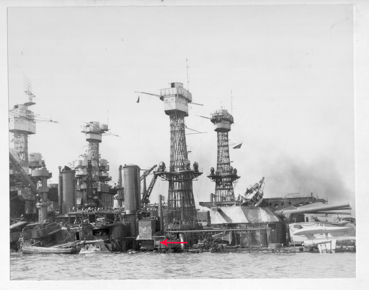

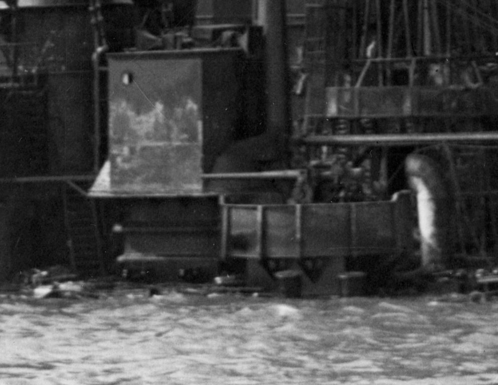

New question:

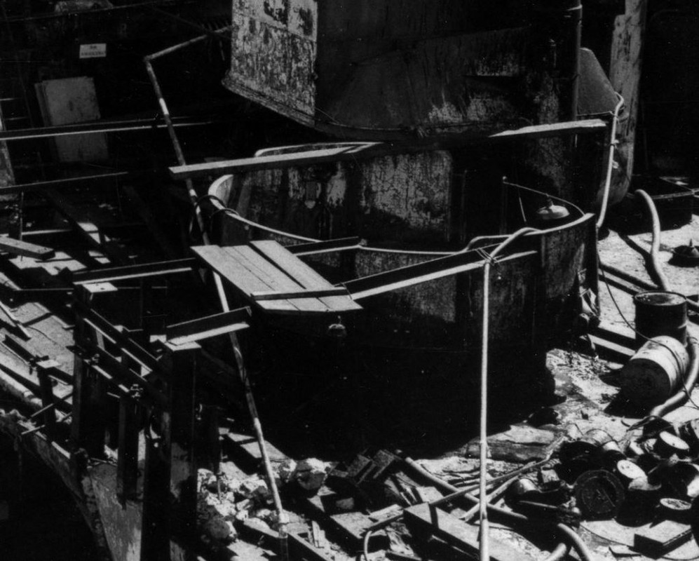

California (and Tennesse) have readily apparent 3" ready ammo lockers in the vicinity of the aft 3"AA tub. It's not so apparent for West Virginia. The few photos of this area are all post December7th, and no locker is apparent in the same location, nor anywhere else.
Does anyone have better information, thoughts, conjecture? I do wonder if the force of two torpedo hits under WeeVee's 3" tub might have dislocated the locker, or it was removed post attack to aid in clean-up.

Dan,
That's a great question. Been looking through my archives and going through the salvage report, but alas nothing definitive. I used my high res copy of the image you posted to zoom in-
The lockers if in the same location as TN and CA should show above water still if they were there. What is interesting is there does indeed seem to be something mounted there or at least had been. Your theory about them being dislodged, while possible I do not feel that there was enough devastation to completely remove evidence of them from the area. Even if they had "Cooked Off" from the oil fires or the fires atop Turret 3, we would see more damage then just a couple of missing lockers.
This image of her refloated shows the area, but the gun tub is obstructing the base of the Projection Booth and obscuring any sight of the lockers. Does show the tub has being open backed however.
My theory is that they are mounted on the Stern facing side of the Projection booth and just obscured by the tub in all the available images.
My $.02 before taxes...

I also looked for any evidence of them but didn't find any yet. I did however start to wonder what the rounded bulges on the projector booth were. There is something attached to the bulge that is facing forward. Any ideas on that? I bet Matt could produce a 3D printed version of this booth complete with the loud speakers on top. Hint, hint!
PostPosted: Sat Oct 17, 2020 9:48 pm
Posts: 8829
Thank you both for pondering this.
Matt's idea about the lockers being placed behind the tubs by the opening makes a lot of sense; even more sense then where these are placed on CA. I can go with that.
Jeff, do you mean at the base of the booth, fore and aft? Isn't that just the top of the vent,with the booth extending down around it? Or am I misunderstanding what you're indicating.
PostPosted: Sun Oct 18, 2020 3:55 am
Posts: 1000
Yes, you are exactly right about the vent. I completely wasn't thinking about a vent under the projector booth. :Oops_1:
PostPosted: Sun Oct 18, 2020 10:49 am
Posts: 1611
Location: The beautiful PNW
Looks like it's the movie screen frame without the canvas screen

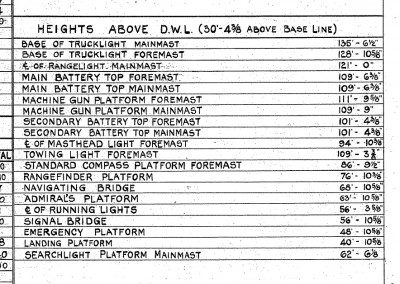

Does anyone have the actual measurements for the cage foremast itself? Looking at the general plans for West Virginia, and using the heights above DWL, I come up with approximately 32+ feet. Do I have that right?
If so, it would seem that kit PE and all the aftermarket alternatives are slightly short.
PostPosted: Wed Dec 09, 2020 9:12 am
Posts: 8829
Great illustration and thank you for posting it, David. By any chance, would you happen to have the foremast as well?
I agree that both mast tops seem to be of the same height, and the West Virginia BoGP that you linked indicates the same. However, the dimensions to the top of the mast that I read/take from those same BoGP appear to be different, at 101+', assuming I am reading them correctly. The plan seems indicate this height is the deck of the secondary battery top, which also the top of the cage mast itself.
Do I have that right and, if so, maybe this discrepancy between sources is the reason the parts are off?
PostPosted: Wed Dec 09, 2020 9:34 am
Posts: 8829
This helps illustrate the dilemma, though not earth shaking by any means. I might have the Blue Ridge version upside down. Not easy to tell with that piece.
