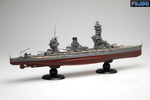

PostPosted: Tue Nov 23, 2010 1:19 pm
Posts: 582
I see that they're still missing a chunck of pagoda, as well as still having the seaplane on rather oddly. :heh:
Current Builds:
1-350 DKM Z-39
1-350 USS Philippine Sea
PostPosted: Thu Nov 25, 2010 1:50 pm
Posts: 2160
Actually the pagoda looks complete to me now
im not seeing the gap that used to be just above the AA platform rear of the pagoda structure, it seems to me it was a rush put together model and the guy probably missed that level's part
Jose :wave_1:

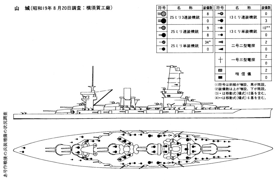

PostPosted: Tue Feb 01, 2011 11:43 am
Posts: 8835
One thing I can post is a Shizuo Fukui sketch of Yamashiro's AA fit in August 1944. As a naval constructor, one of Fukui's assignments was to sketch the AA layouts of various remaining IJN ships during the summer of 1944. I know he did an extensive survey on the DDs; I am less familiar with sketches of other types. I'm not certain if his assignment was to include ALL remaining ships, or just certain types or some other parameter. These were all published in a series of very hard to find ship type historys in Japan.
These sketches are considered authoritive as they were made first hand by someone whose job it was to know. I've not compared this to the Ishibashi volume.

PostPosted: Tue Feb 01, 2011 9:29 pm
Posts: 3134
Location: Oslo, Norway
Wow thank again Dan for the nice replay/diagram, one last question cause I cant figure it from the picture, is the 25mm AA guns on top number 2# and 5# triple or double ? Number 3# and 4# seems to have double 25mm AA. Fuso and Yamashiro's light AA suit is almost identical.
Anyway thanks again Dan :) Excellent work on FineMold's Ayanami review by the way. Keep it coming ! :)
PostPosted: Wed Feb 02, 2011 10:08 am
Posts: 8835
Fukui's diagram for Yamashiro indicates doubles for all turret tops whereas Fuso's #5 seems to have triples.
