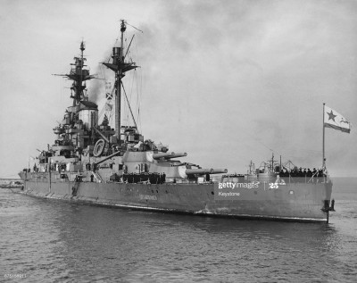

At a glance can anyone tell what Royal Sovereign was painted as seen here while she was still Arkhangelsk? Appears to be a two tone scheme, dark hull and lighter upperworks. The funnel is even lighter.

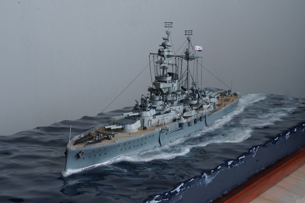

I used Humbrol No. 5 Admiralty Grey Gloss for the hull and Humbrol No. 196 Light Grey Satin for the superstructure and upperworks on mine. Then Humbrol No. 125 US Dark Grey Satin for the steel decks. All sealed with a coat of Humbrol Matt cote. The colours are a pure guess on my part, I have no idea how accurate or not the shades are?

Thanks MrChurch. I will improvise the greys. You have an impressive model there. I've never attempted diorama water but yours looks fantastic and 1/500 is a nice scale for such a project... How did you make the hull waterline? (I've already started my hull and glued the halves together.

Thanks Spopovich. Simple answer is I did not waterline the hull, the full lower hull is actually still there but out of sight below water level.
I carefully prepared the hole in the base and matched the ship up to it. Then finally filling in any remaining gaps with Artist's Medium and cotton wool. Water methods are as per this excellent tutorial here from sargentx:
http://www.shipmodels.info/mws_forum/viewtopic.php?f=4&t=155661
