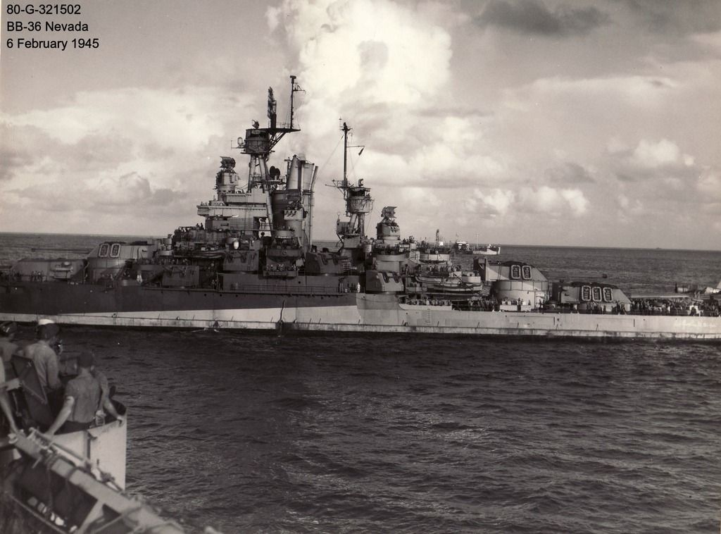

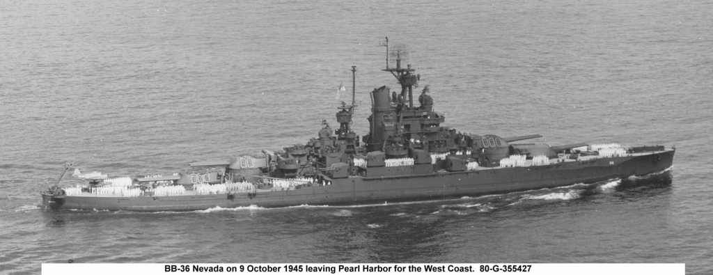

PostPosted: Tue Sep 15, 2015 9:03 pm
Posts: 3841
Here is NEVADA in February 1945
And her is NEVADA in October 1945
She was repainted sometime after Okinawa if the dates on Navsource photos are correct. The September 1945 showing her in Ms 22 is likely from her time off Normandy in June 1944.
Short answer to your question is that "YES" she likely would have been painted in ms 21 for the invasion .... UNLESS the USN decided to change camo schemes again before then. :thinking:
